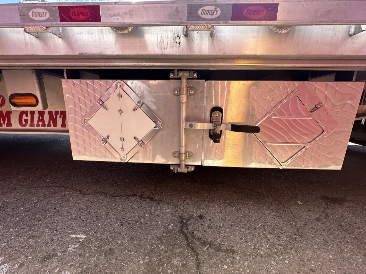

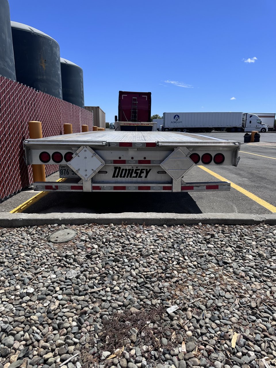

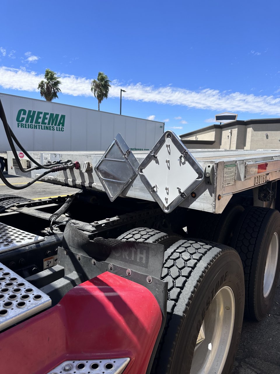

    That’s why I went with 2 on each side. One flip card with 17 legends (bummed it didn’t have 18 with radioactive) and one holder. In case the shipper was shipping multiple hazmat items. Here’s how I did it. The front ones are the only ones I didn’t rivet so I can remove them if needed. if the front had 2 stake pockets I would have just mounted them on a 2x4 or something to put them on. Might have 2 made so I can weld them on and use stake pockets instead. But for now this works.

    You can buy the stake pockets and bolt them or weld on front of trailer.
    Parts house has them .
    I use magnets and have not lost one yet on the front.
    Most of the people around here use C channel for using in pockets of trailers.
    If you don't have the panel you need you can alway drill out the rivets and add what you need.
    You can buy panels or find them on the side of the road ( much cheaper ) I find all kinds of stuff always looking ...

    That’s what I plan to do in the future. I’ll get the stake pockets and have them welded on. My trailers all aluminum, I didn’t think the magnets would work but it is a good idea. As for the panels I think the only one it’s missing is radioactive, it has everything else.
