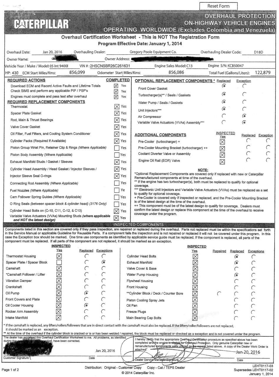

    I just had a platinum done about 3 weeks ago. Cost me 23,800. After hearing your story I'm glad I let cat do it. Here is the warranty

  10. HalpinUout
    HalpinUout Road Train Member
    7,074
    18,165
    Oct 2, 2011
    The bottom receipt shows your name and address, I would delete that
