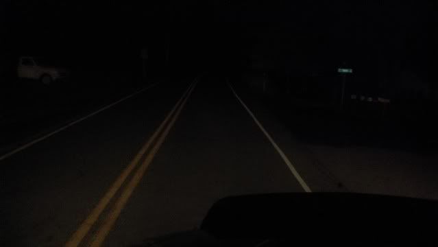

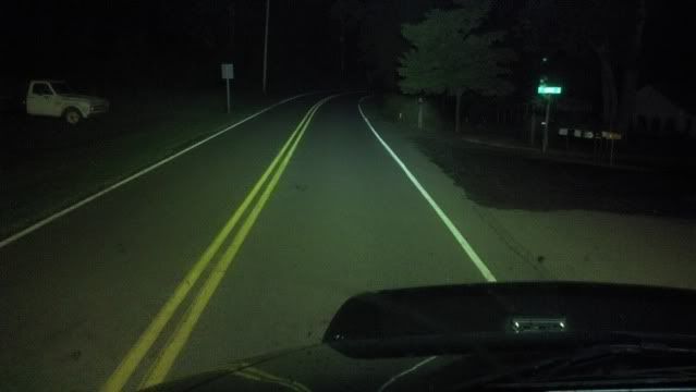

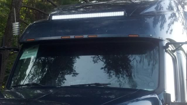

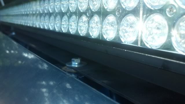

    I bought this 44" LED light bar off of E-bay and installed on an aluminum angle on top of sun visor. Wired into high beam side of fog lights that I have removed. This is the same type of light bar that offroad racers use.
    240 watts that is 80 - 3 watt LED bulbs.
    High beam headlights only
    LED Light Bar on....
    They work great and do not draw as much energy as a pair of regular fog lights. It would take over 15 regular fog lights to equal this one light bar with the same number of lumens output.
    The deer actually run back into the woods with these that I mainly bought for those night driving ventures in unpopulated areas of this country. I have also been DOT inspected twice since installing them with no problems or violations for these lights on the truck.
