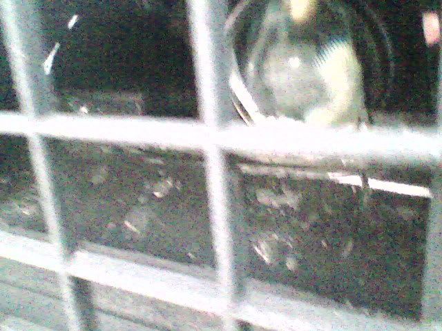

    Aerostar with 165 mm hella headlamps.
    Projector from broken Volvo Version-II headlamp. Was sealed. With HID bulb
    All lamps are on.
    Do the same conversion with your truck and it'd be better, easier to drive when it is dark, and do it for safety.
    I put HID in projectors only to avoid glare. fog lamps look bright becouse camera was positioned low. really foglamps are low beam projectors from Volvo headlamps
