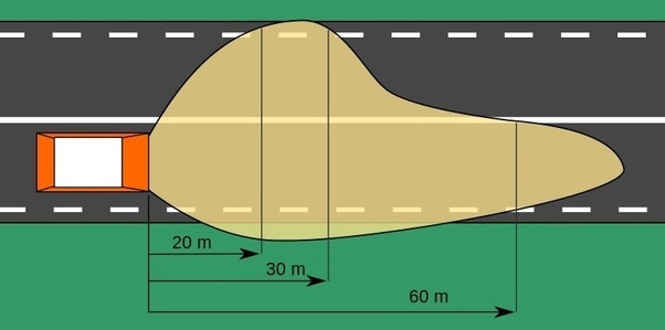

  5. Ridgeline
    Ridgeline Road Train Member
    22,742
    123,696
    Michigan
    Craig, the lights have a cut off point on the left and a lead on the right. Like below. It may be a lens problem but it also may be a lamp issue, I had a problem where we could not get the lights to focus right and it came down to the bulbs were OSRAM were counterfeit bulbs and just horrible, put another type in and it all worked well - that was a $300 expense I didn't need.
    However ... have you actually checked to see if the lights are aimed right?
    How to Adjust Car Headlights
    25(2)+2 Thanks this.

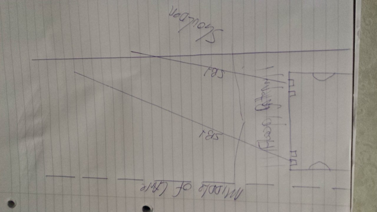

  6. craig_sez
    craig_sez Road Train Member
    5,570
    2,714
    Sep 5, 2013
    novascotia,Canada
    They were originally height wise but way low..I was over driveing even at low speed..A very basic idea of my light pattern.. 1541976734070-979616554.jpg
