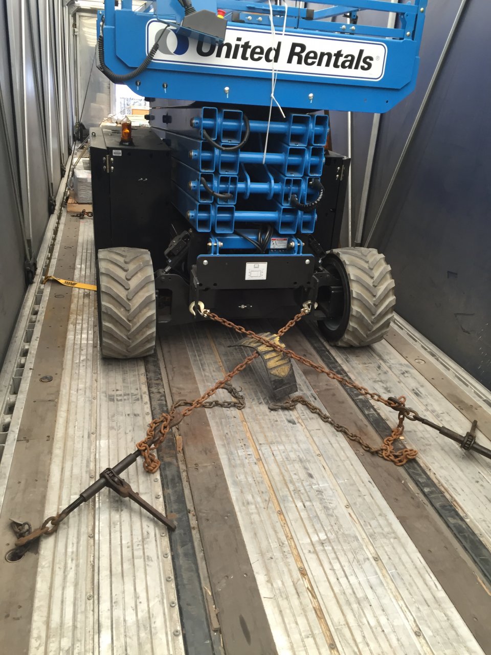

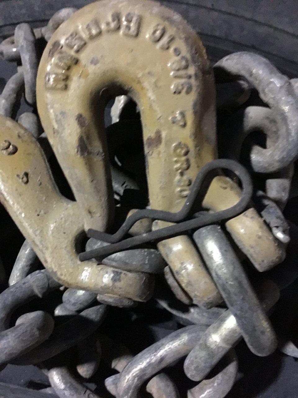

    I'm not a HH guru by any stretch. I have 4 tail chains made up that are 8 feet long. One of each style hook. They are the cats meow for equipment. A lot of guys use the pull type pin in the second picture instead of a cotter key. I carry 8', 10', 12' and 16' long chains. I probably wouldn't get 10' again. A lot of HH guys have 4' and 6' too.
    You might also want to get binders with the large slip hook end to go right to a D ring.
    I just got a 12'x16' tarp, d rings on all 4 sides. My other tarps are 16'x24' again d rings all 4 sides.
    No you would not need to remove a hook to use a chain drop, if it's the style I'm thinking of.
