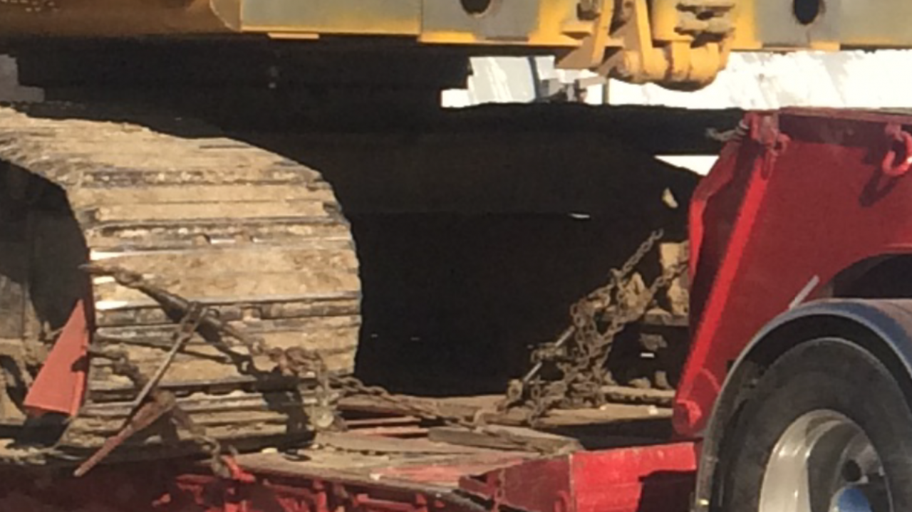

    On my 55 ton I carry 8 1/2" chains 36" long. Grab hook on one end slip hook on the other. I use them more than anything on machinery, on my 60 ton I transfer those over and I have 8 1/2" maybe 12' long.

    I will always cross chain when I can. At 15 feet wide and 16 tall with top heavy pieces I will not just secure to the same side. Same thing with cross chaining machines on double drops. I'm not going track to trailer on a bad Angle.
  8. johndeere4020
    8,522
    119,296
    Jan 1, 2010
    I go from the outside to the middle of the trailer, if it's too heavy I try to get some pulling straight down.
    If you can see the chains I have here, I have the one on the left side of the picture I'm hooked to the outside of the track then to the inner beam. The chain you can see on the other side hooks to the beam then around the idler and back to the beam. I can see any advantage to taking those chains to the other side of the trailer. Not saying my way is right and anyone else is wrong, just my train of thought.

    I'll do the same on a lowbed but most double drops are one solid deck so no option to go to the centre.
