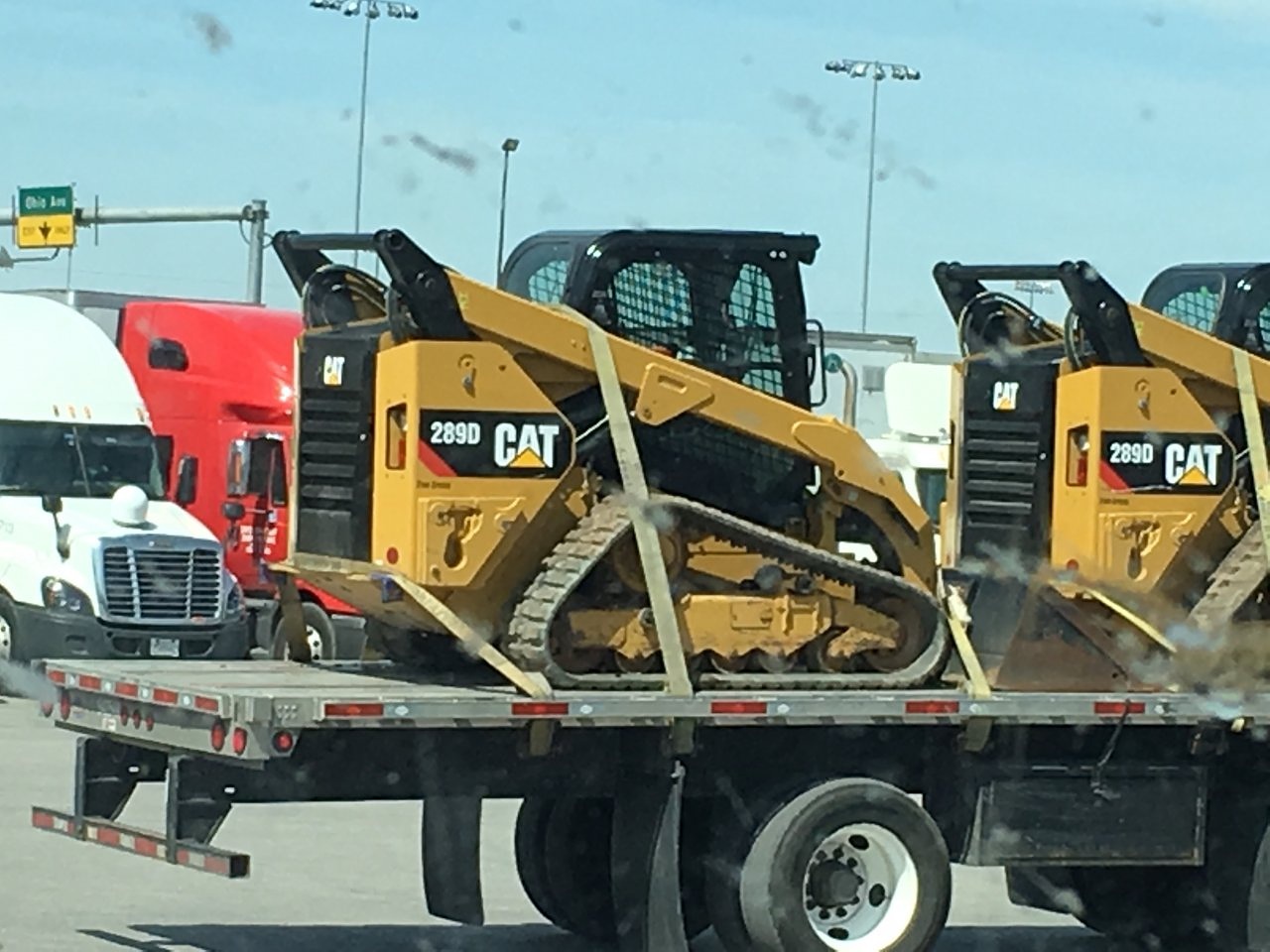

  6. only purpose for strap is for any item the customer doesnt want chain marks on the nice pretty paint. (hoods, doors securing a small attachment that cant come off the main unit)
    if your shipper has prepared your item right. it shouldnt have any questonable parts that need a strap. some use straps when chain is supposed to be used.

    WTF!!!
