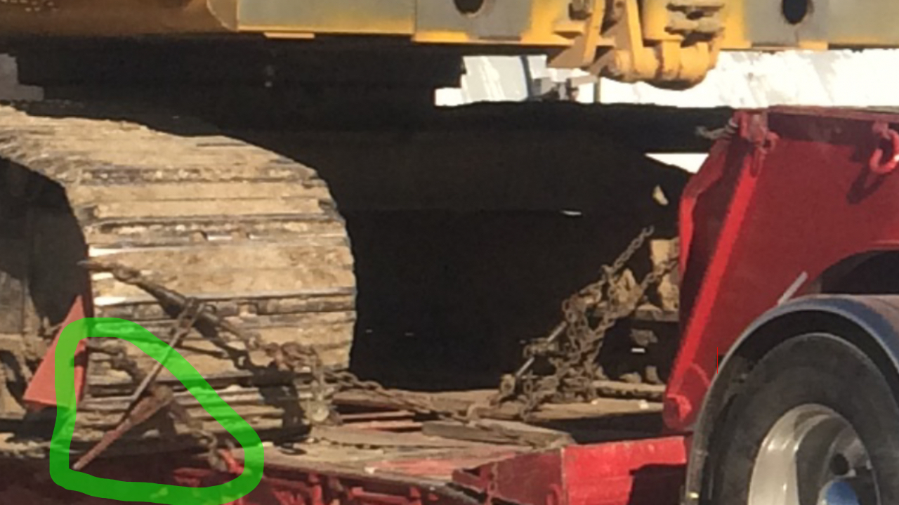

    I'm sorry to tell you, this chain counts for nothing!
    Yes, I am aware that almost zero DOT officers will know it, and almost none will cite you for it becaus they quite frankly aren't aware of the actual reg's regarding this practice.
    A binder that is attached directly from cargo to trailer/load security devise (D-ring in this case) has NO SHOCK ABSORBING CAPABILITIES and is therefore not counted in load security aggregate load calculations. Binders, chain hooks, D-rings, frames, et al, are constructed of forged or temper hardened materials that have no "stretch factor" and therefore cannot dissipate a shock load safely or properly without significant risk of failure. There MUST BE G70 chain between each component.
    Contrary to popular belief, grade 70 transport chain is engineered to "stretch" and will absorb said shock loads and safely dissipate the energy without significant failure risks. Other grades of chain DO NOT have the metallurgical makeup to properly do this.
    I know the popular argument, I've heard it countless times, grade 100 has so much higher ratings and my rigging supply blah blah blah. If such is the case, simply asked "Why won't any Red Seal Crane Operator use Grade 70, even at its lower rating, to lift with?"
    Simple, G70 is NOT lifting chain, it will stretch and they cannot properly calculate this factor. And G100 IS lifting chain, will not stretch, and IS NOT security chain. G100 CAN NOT absorb and dissipate shock load sufficiently. Cranes don't shock load their rigging during lifting, trucks hit thousands of shock loads (bumps) daily.
    Yes, I've heard the argument. No I won't listen to it. Yes I have read, and I actually do understand the engineering technical data behind it, which is why I won't listen to or argue it.
    Despite the fact that this is an unpopular view, doesn't mean it's incorrect, and it peeves some people off...but sorry, it's not incorrect.

    I'm assuming your drunk, so what the heck are you talking about? Can you show me any rule that says a binder can't attach directly from the load to the trailer? No you can't, that's probably the stupidest thing I've heard in a long time and because it doesn't exist. And your self absorbed arrogant I know everything because I'm the only that's ever hauled a big load attitude is over the top. You wrong by period, you don't know more than the engineers and metallurgists at Crosby, I don't care who your uncle is and and I don't care about your antidotal examples of you load securement.
    You and your rookie buddy think that acting like A- holes all the time make you something special but it doesn't. You do your thing and continue to profess your greatness to those who believe it and I'll do mine. But if it's a fight your looking for I can hold my own. That my suggestion.

    Can you post a regulation or ANYTHING from the FMCSA that says that? Maybe that's why no dot officer will give out citations for that, because it's not a violation...
