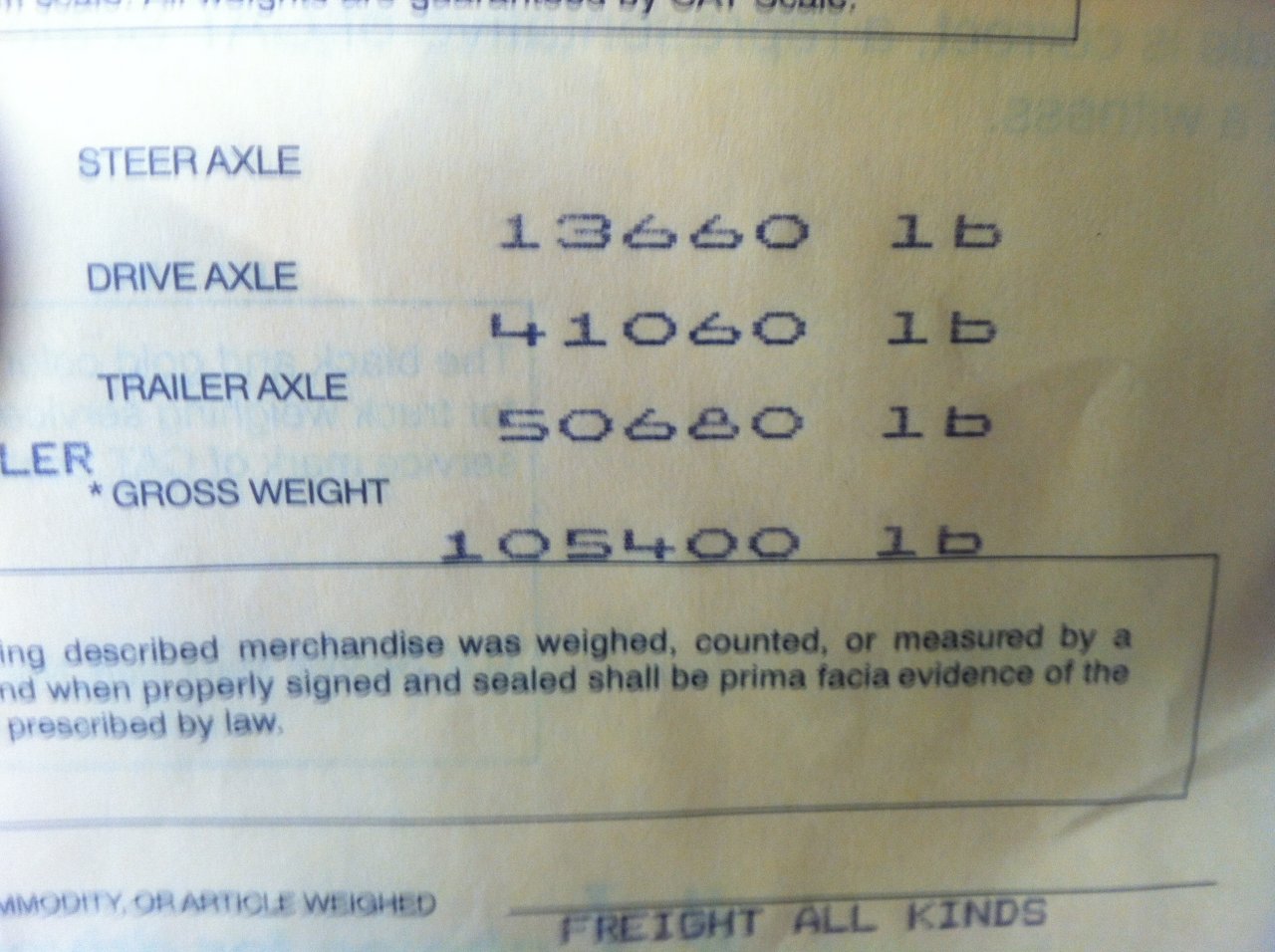

    I use those kind of specs with a 3 axle trailer on these loads every day.....

  9. nate980
    nate980 Road Train Member
    2,020
    5,225
    Dec 23, 2010
    Langley BC
    Last time I ever listened to a consultant.....
    D8 pulled me out lol
    j_martell, AModelCat and Dye Guardian Thank this.
