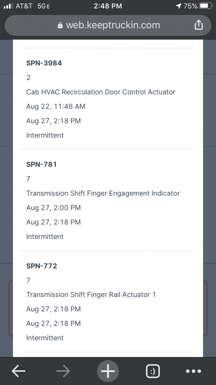

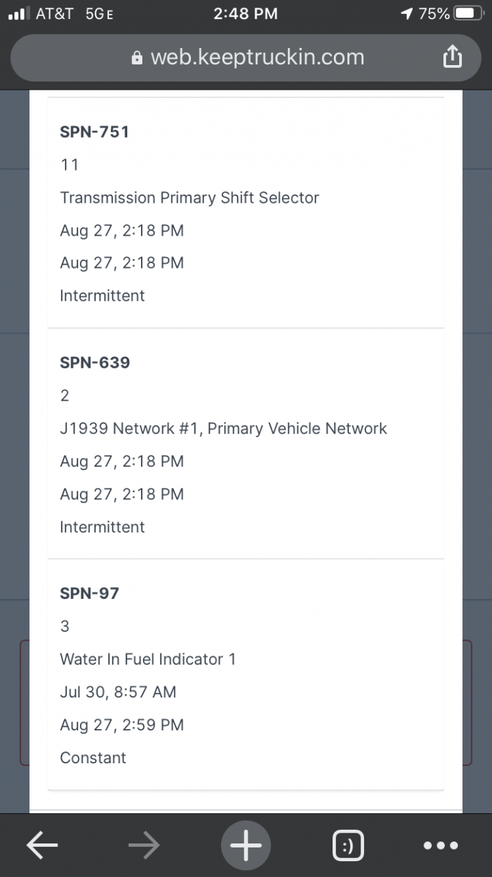

    Loss of throttle will cause this. You have several accelerator pedal sensor codes. I would start with this. Check the connector at the pedal for any corrosion. 90% of the time, it is wiring problem somewhere, so replacing the sensor will likely not fix the problem.

    9F36BF0F-F107-4BE5-8CFB-FD84020867D9.png 89C2D236-1AD9-4EAD-BA2A-F3A2C8096675.png Truck just lost power driver restarted it after 15 mins and runs normally,water in fuel and ac codes were there for couple of weeks but dont affect driving.
    This truck is money pit and its 2017 prostar
