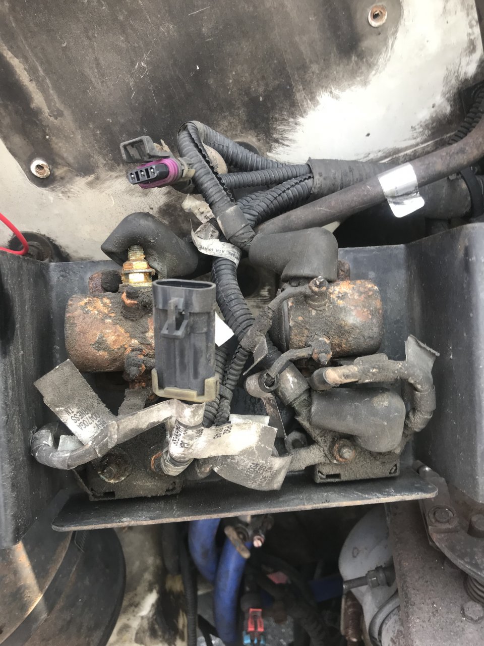

  8. caseyd40
    caseyd40 Bobtail Member
    5
    1
    Aug 22, 2018
    I did find this on the firewall. It’s at the end of the harness that tails off the clutch fan Solonoid power/ground. Not sure what it is but I also cleaned and got all corrosion off.
  9. Goodysnap
    Goodysnap Road Train Member
    3,774
    9,202
    Jul 12, 2017
    Without digging into wiring by VIN, I would say that this is the intake or grid heater breakers and control solenoids. The 3 pin is likely the control for the relays. If you trace the large cables out of the relays you will locate the device which they operate.
    spsauerland Thanks this.
  10. spsauerland
    spsauerland Road Train Member
    4,296
    10,891
    May 31, 2010
    West Harrison, In
    Zoom in and one cable is labeled "intake air heater".
    Goodysnap Thanks this.
