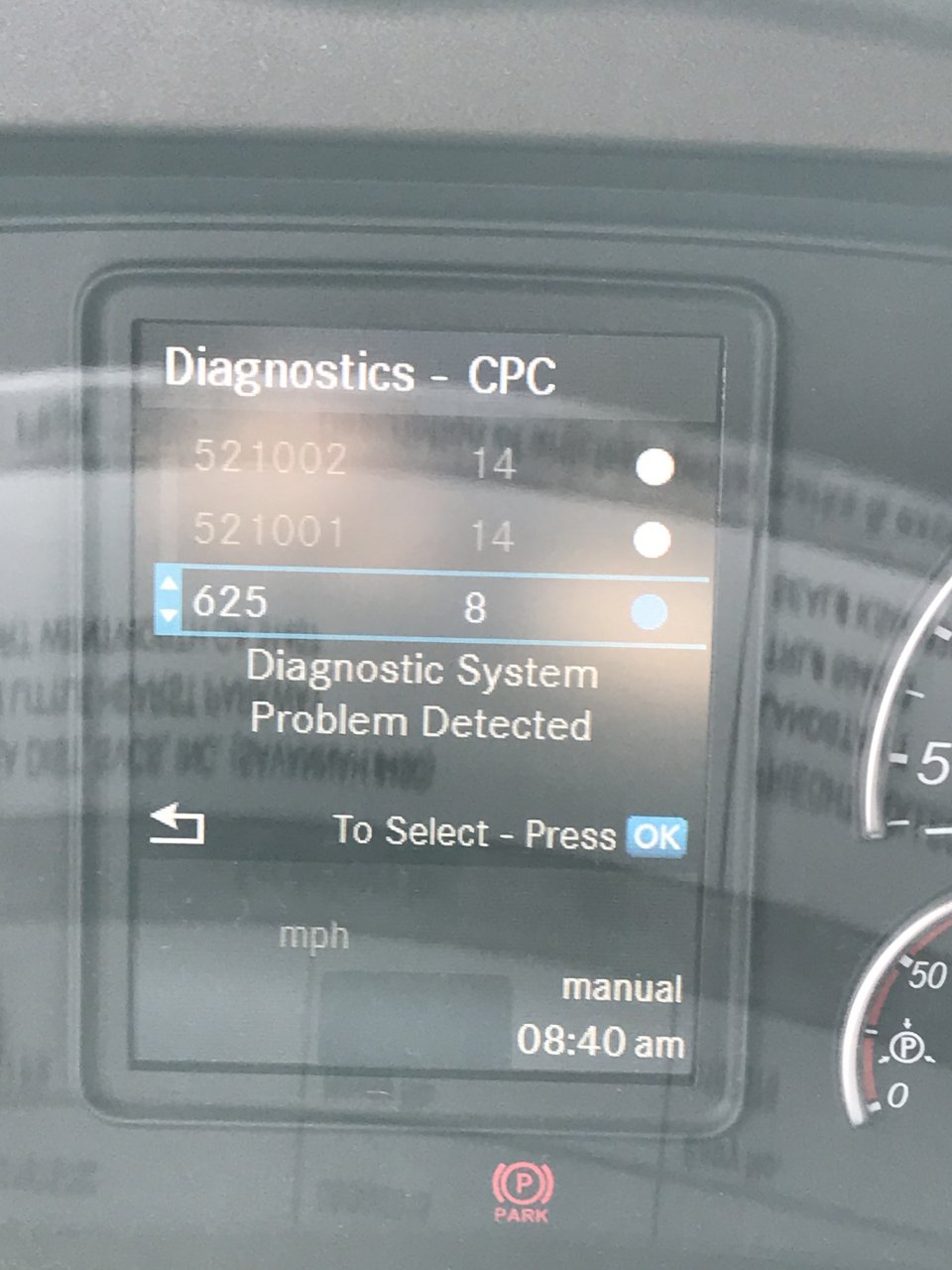

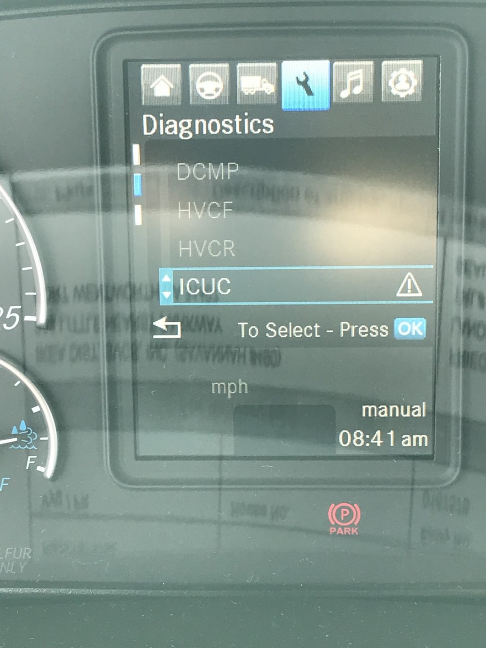

    truck shot down, there is no connection between the computer and the engine. the battery is OK.
    TA tried to replace the fuse, after that the shotdown. :(:(:(:(:(:(:(:(:(

    what computer starts engine, where it is located?! can this be just a fuse?
    The problem is still not found. :(:mad::( and very expensive .... time is money

    open the hood. there is a box called PTPDM on left side on splashguard(I am not sure what is the correct name of that plastic). there are few small fuses. check them. Under vibration these fuses crack and make problems like yours.

    This is a good start. Beside the fuses, this module is also known to have cracked and broken bus bars that supply the power to the fuses. Stick a volt meter on various fuses and give the module a good tap or shove to see if the voltages get interrupted.
