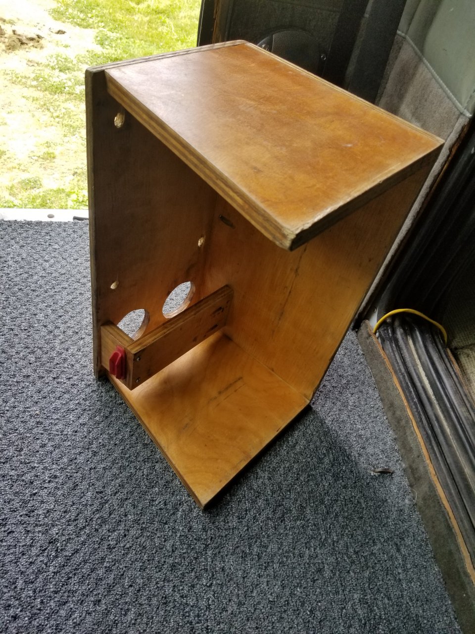

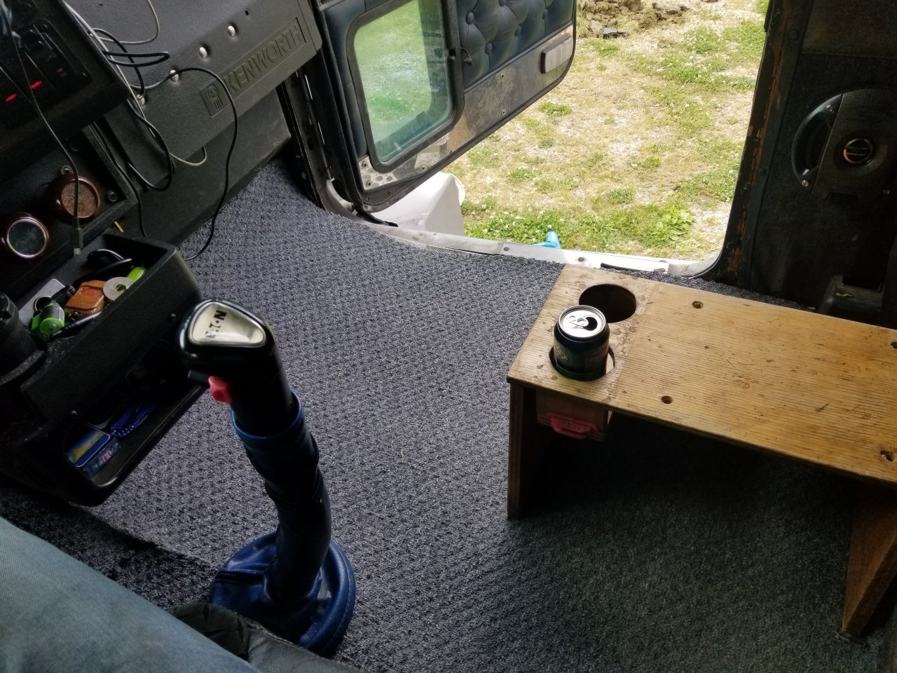

    That's exactly what I was envisioning construction wise. Looks like closer to 3/4 ply and some angled dowels on the inside shelf? Looks super sturdy. Good job. But I was thinking of a larger structure and at 60lb per 4x8 that gets heavy faster than plastic LOL
    Rideandrepair Thanks this.

    3/4" ply ends, top and rear stiffener are 1/2" ply
    All put together with 1-1/2" pocket screws. Thats 9 years old at this point no loose screws and ive taken it apart a few times to sand and refinish it. weighs at most 5 lbs. If you are heavier (im 150lb) and want it strong enough to jump on id build the top from 3/4 but its good for 250 lbs as it is if youre stepping into the back on one foot on it.
    I also pocket screwed the drink shelf, made my brother one 2 weeks ago, ill try and get some pictures of it, just ran torx screws straight through the panels and sides for the drink shelf, didnt want to deal with the pocket screw setup for minimal cosmetic gain
    Rideandrepair and Qbf594 Thank this.
