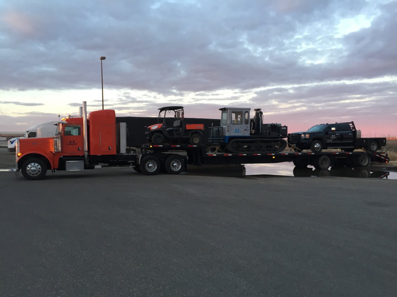

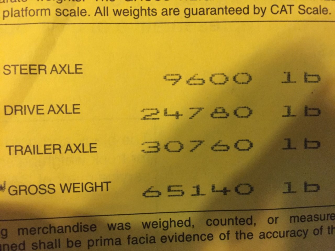

    image.jpeg image.jpeg Well guys I finally got around to getting all my equipment loaded and made a trip to the scales. I loaded the heavier machine in front. I actually had more room than I thought on the deck so I didn't have to have the heavier machine all the way forward. It worked well and I have plenty of room on all axles.

    Not bad, I personally prefer my steer heavier but it's a matter of preference.

    I can't get the steers any heavier. Well maybe a little if I put more weight on the drives but where my fifth wheel is now my mudflap hangers miss my trailer by about an inch.

    I think it is fine if everything was heavier you would have more weight on the steers

    You will be fine like that. Just remember, you have more weight on the trailer.
    No problem on the highway, but if you get into soft dirt, the trailer will tend
    to sink in more than the truck. Or when turning on gravel road, the trailer will
    try to push you a little. Be careful and you will be fine.
    The ideal is to have drives and trailer equal, with the drives heavier if there
    is a difference. For better steering, especially in low traction conditions, it is
    better to be a little heavier on the steer tires. The theory is you can carry the
    weight easier than you can drag it. With your situation that is the best you can
    do.

    Like others said I am sure it is fine as is but this is a specific load I will be carrying a lot. Many times I may be on dirt/ gavel roads. I could move the 20k machine and the pickup forward a few feet. I don't have a lot of room but have some. I wonder how much I have to move them to make a significant difference?
    This exact load may go on the trailer several times a month. I would like to get it exactly where I want it and then mark the trailer where everything goes.
