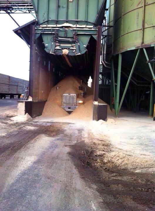

  9. Ezrider_48501
    Ezrider_48501 Road Train Member
    3,845
    5,135
    Apr 2, 2011
    bismarck, nd
    load em like this?
  10. d o g
    d o g Trucker Forum STAFF Staff Member
    24,759
    54,448
    Sep 20, 2010
    Texas
    Wow, that would make me angry.
    blade Thanks this.
  11. Ruthless
    Ruthless Road Train Member
    9,258
    92,206
    Aug 28, 2010
    The City.
    Trying to to get more on the steers :0
