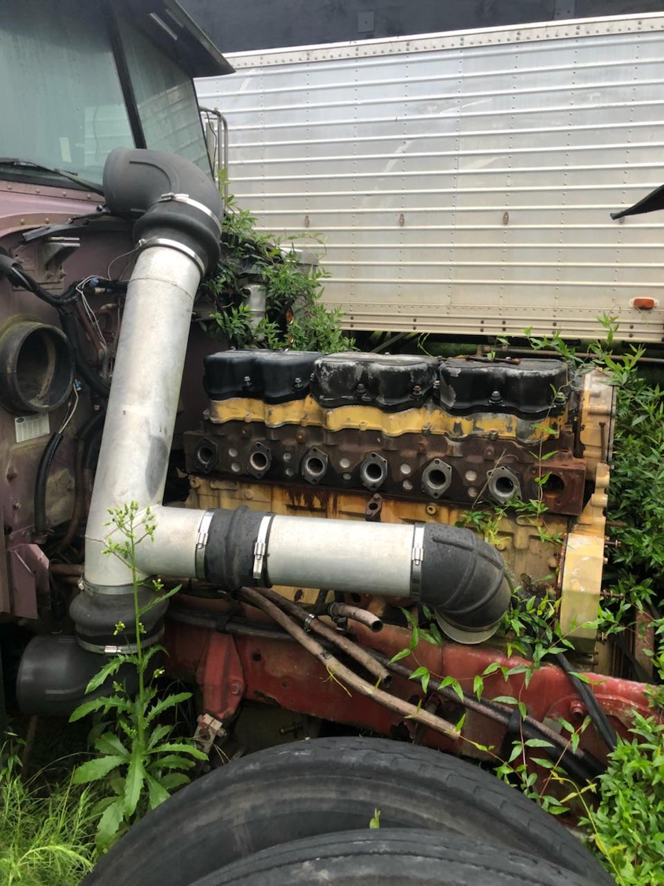

    Ok, so I bought a 2000 Pete 379 with a 2ws in it minus all bolt on accessories, so just rocker boxes, head, and block with all internals. Supposedly it had an inframe done and only has 65k on it before it was parked and started getting robbed of parts. The head is bad so it needs to be rebuilt anyways.
    Here is my dilemma, I have wanted a complete 99 6NZ and been looking at them to drop one in it and been back and forth over that or rebuild the 2ws and purchase new all the bolt on ####.
    Well, this morning I found a thread on here from Jan. 2018 about turning a 14.6 into a 15.2 and @superhauler and @spsauerland posted the internals needed. So now I REALLY dont know what to do lol.
    Besides the obvious displacement difference in the 3406E and C15, I know the 6NZ has better orings/gaskets for sealing and correcting the oil leaks and also has straight cut gears but thats really it.
    Ugh, what would you do?

    Not even close to complete. Only thing there is block (with internals), head, and rocker boxes. Everything else under the hood is gone.

    I dont have a 6nz
