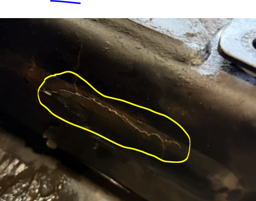

    I found where the radiator frame cracked and it was squishing the radiator from the bottom, I am having one made currently but time is the problem god knows how long that will take

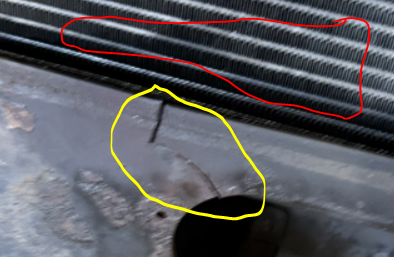

    Is this the crack? This should be able to be repaired.
    The yellow area below can also be repaired.
    The area circled in red is the core. The radiator should be able to be re-cored. See post #13.
    If someone made you the wrong one then you need to find another shop.
    No conversion should be necessary.
