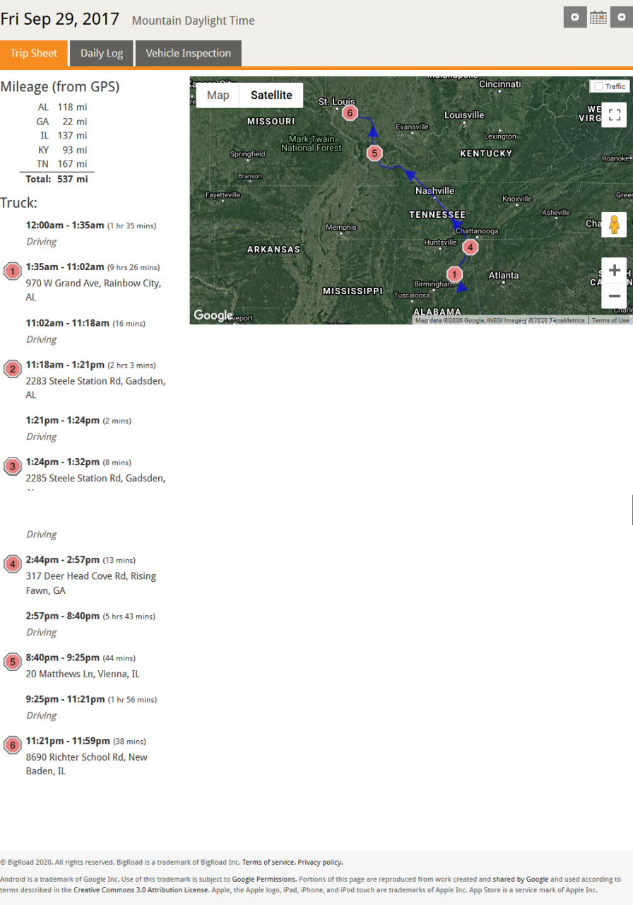

    Now is bad news. IFTA auditor will use PC MILER to calculate your miles from location to location. When they did my audit i gave them every day detailed driving map.
    So my IRP was accurate but IFTA little bit off. Tell me how? I did use same data for IRP and IFTA.
    So $36.00 penalty. But my dude was honest and warned me about small penalty forefront.
