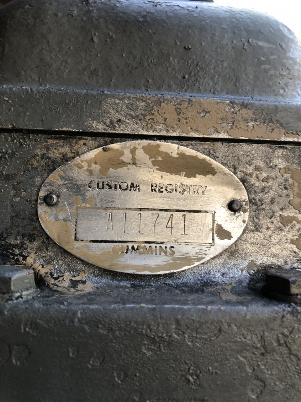

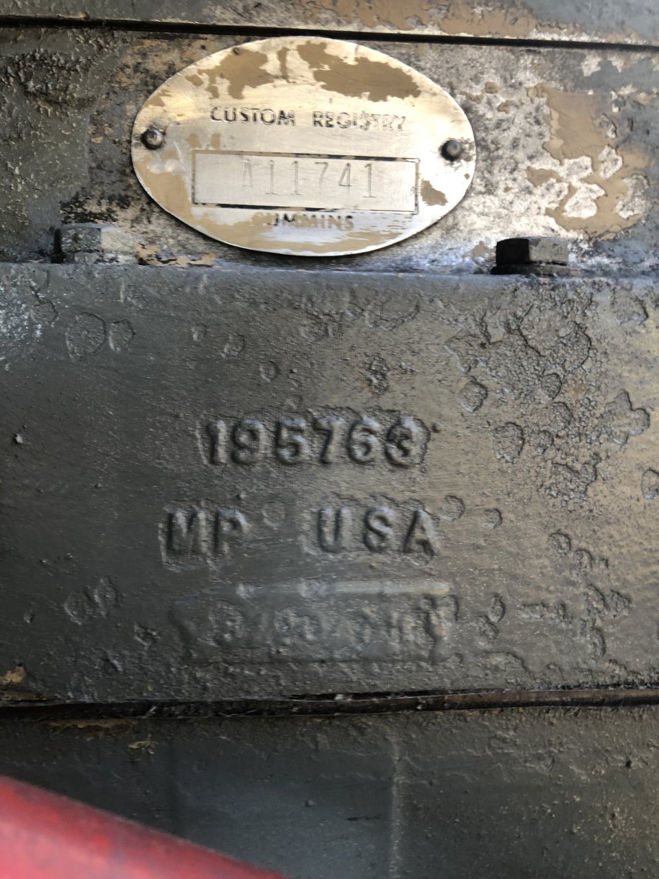

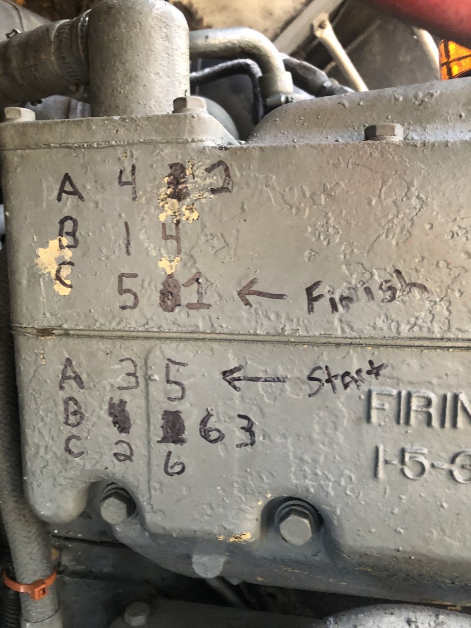

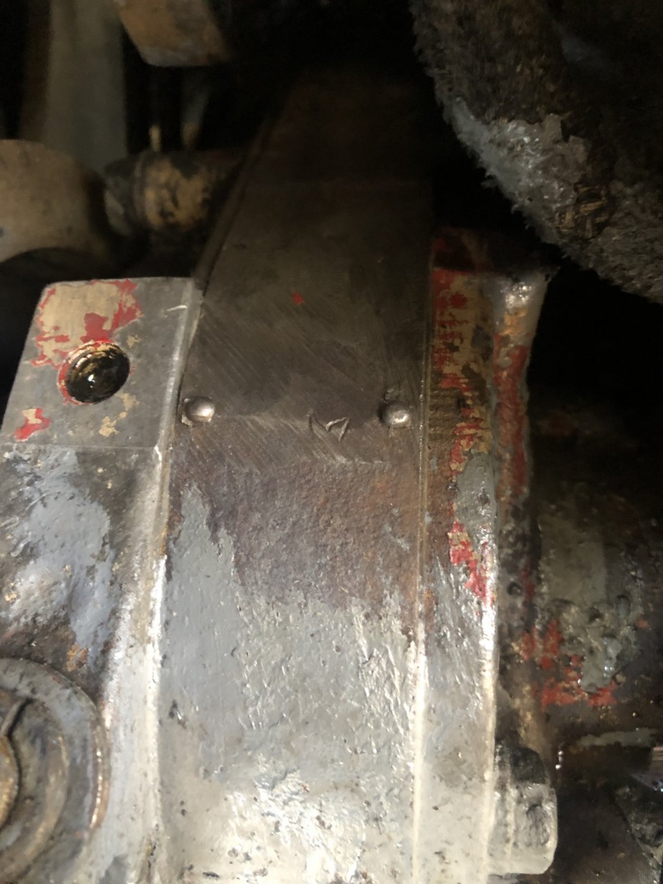

    OK I’m getting ready to redo the injector cups and reset the valves and the injectors. I’m trying to figure out exactly what I have here. Maybe these pictures will help I don’t know if it’s a 350 or 400. Please advise if you can.
    Judging by the markings and the gray paint over the original Cummins paint, I believe she’s been restored, but not sure.

    Also I can’t get engine to turn over by using socket and cheater pipe at all but can bump it with starter?!
    Why is this? Is there a compression release somewhere?
    also engine serial number locations would be very helpful no data plate does have Cummins Custom Registry but can’t find help on this

    Well first off… look on the left side of the block just above the oil pan gasket, is the words BIG CAM casted in the block, be right in front of the starter.
    2nd, should be a tag on top of the fuel pump, will have your fuel calibration code on it. A good pump shop can use those numbers to tell you what horsepower it is calibrated for…..
