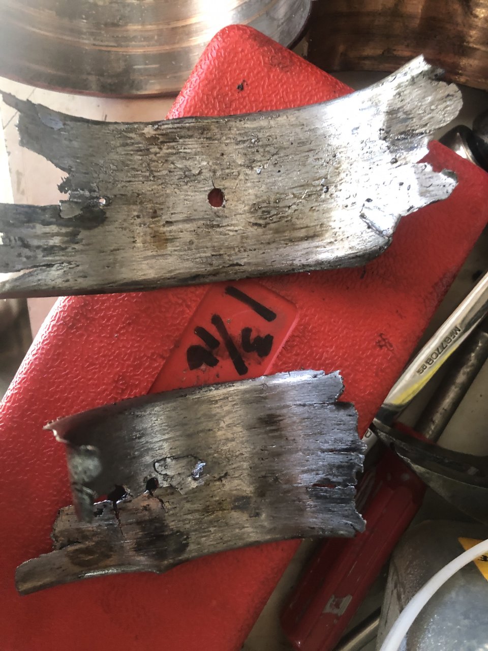

  7. Binderdavemays1
    Binderdavemays1 Light Load Member
    173
    83
    Jul 30, 2024
    Luebbering Mo
    Ok so latest update #4 rod completely spun and trashed #3 almost as bad #2 was trying to spin….
    #4 on crank has bearing pieces welded to it
    #5 main bearing has heavy scratches and wear see photos
    What’s my best case scenario to clean crank up especially #4
    also what would cause this so it doesn’t happen again?

    Next question, would I be better off buying a different used motor?
    And if so should I stay with small cam or switch to big cam Cummins?

    #### ! them ######## are chewed up .

    Myself I'd yank the engine and send the block and crank out to a machine shop. Its really not very expensive. I had a 3406 block get hot tanked, decked, all 6 liner seal bores cut/sleeved, crank and cam polished for about $3500 Canadian.
