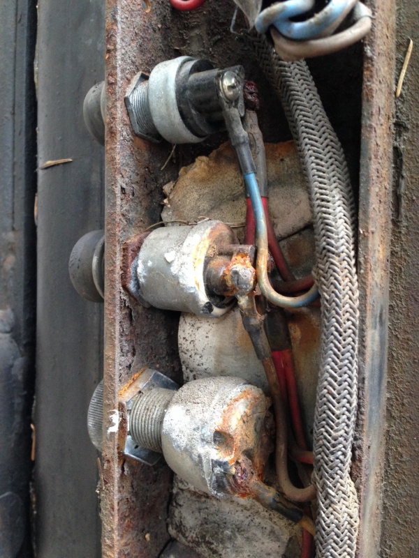

    Here's the backside of the switch box... pretty nasty looking.

    Ok, I'm only getting 1.5-4.2V across the backs of those switches. Things must just be too rusty and corroded I'm thinking.

    It's a good possibility since the whole system is 12V. The battery arc was enough to finish the poor connection off. Look at the grounds too.
    EDIT: Wow, I just looked at that picture. Yeah they are extremely corroded. Take those wires off and clean them up the best you can. If you have some dielectric grease available smear some on the connections after clean up. That will help stop future corrosion. Is that suppose to be a water tight box? Bad gasket? Figure out how to seal it... silicone?

    Yeah it's pretty incredible it was working fine a few months ago in that condition. The box was missing one of the screws that held it in place, and the top screw just popped out because it was so stripped. I don't think it even had a gasket either. Just some old canvass type stuff shoved in there which probably doesn't help much in the Pacific NW. I'll get some silicone for it once I get it cleaned out.
    Can't thank you enough for your insight. Should be able to get this fixed tomorrow so it can go back to work.
