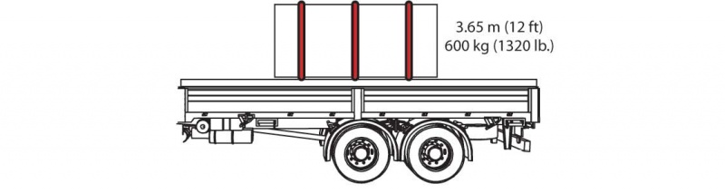

    That article is 12 ft long so wouldnt it meet the "2 straps for first 10ft and 1 strap for the next 10ft or fraction thereof" The extra 2 ft requires a 3rd strap.

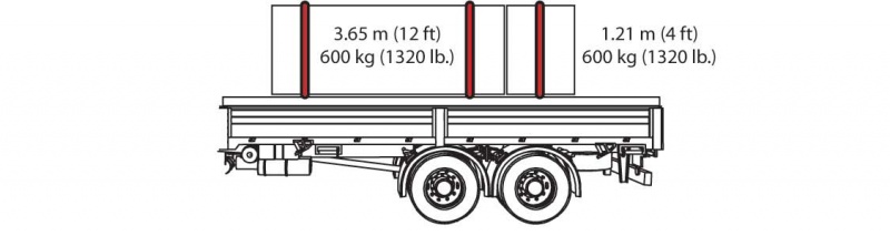

    Same as this...
    artist's rendition.

    Okay, so move the little box in front of the big box, is it now secured the same? Or will you now have 4 tiedowns for 16 ft of length? Yes you will, and the first two will be within the first 4 feet.

    Why would it require an extra strap just because the little box was in front? It makes no sense whatsoever.
