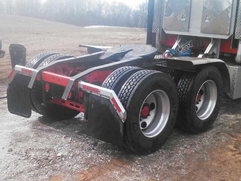

    Ok, you guys convinced me - behind the cab. What exactly do I need? I still need that Y-pipe. Since it's still going to be chassis mounted, I don't need a flex pipe do I? I'm assuming just some generic pipes to extend back underneath the chassis? And lastly, exactly what kind of mounting brackets do I need on the chassis? I'm assuming that straight stacks are much lighter than that fatty catted muffler I have, so I don't really need that massive support post for them, do I?

    Is your exhaust above or below your frame currently?

    What I would do....
    Get a generic Y pipe and figure out how to get it under your sleeper close to the rear of the bunk. Figure out what pieces and elbows you need (or even just flex pipe since it won’t be seen) and get the exhaust to the rear of the bunk at the outside corners. Get whatever size straightpipes you’re going to run with a 90 degree elbow at the bottom. Then I’d just mount the pipes directly to your headache rack, between the headache rack and the back of your bunk.

    Where the cab supports crosses the frame a 5 in pipe will not fit, you will have to get creative and notch a flat spot in it, both sides.

    Right...I forgot about those flat spots. Well, I'll figure something out. Looks like this model makes it a pain in the ### to work on exhaust parts. Guess I'll stop by some shops to get an estimate.
