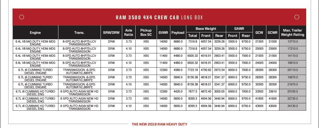

	Yea, the listed weight doesn't include the upfit weight. I'll tell you something more, it doesn't include my dual fuel tanks or any other extra options I bought the truck with. My truck weighs 9300 lbs full of 74 gallons of fuel, some kit and me.
 Where did you get that chart from? And that is what I meant if 33k lbs was my hard limit as it shows in the chart yet on the same line it says I have 25k lb tow capacity. It doesn't add up.

 Ram body builder site has the same information.
 The numbers are close.
 Base weight 7723
 Hitch crafters 740 +or-
 Fuel 525 +or-
 Total 8988
 Max Tra 25130
 Total 34118
 Take away fuel and Hitch crafters you have 3285324kHotshot Thanks this.
	I finally understand how they got 33k gcw and from that 25k max tow capacity. So I can't calculate the trucks 14k seperatly from the trailer's 25k. Then I guess my truck can't really pull a loaded belly loader. Might have to look for a lighter 4 car trailer and register for about 35k to be safe.

 Check out the 3500 with 4.10 rear on this chart. Big difference on gcwr (33k c@c) (43k pickup)
