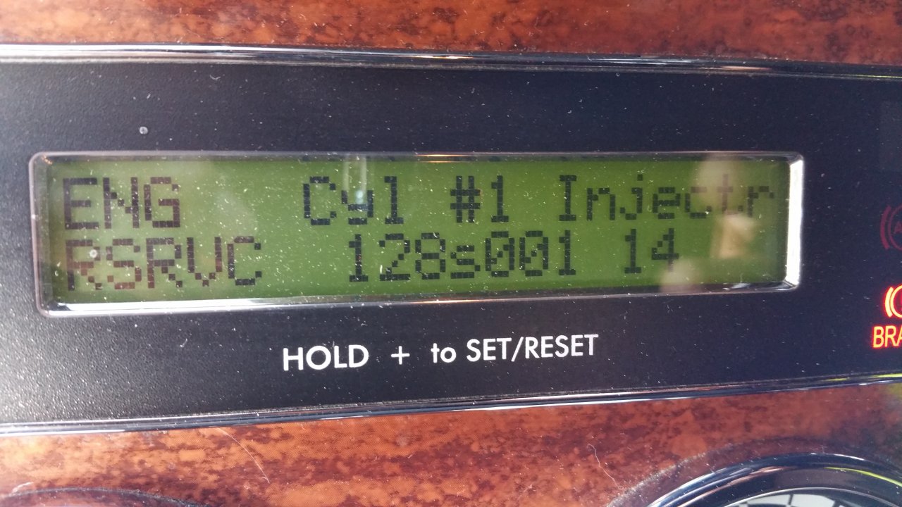

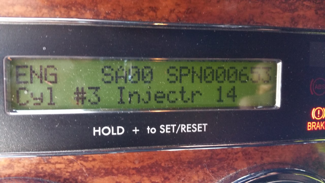

    Thank you so much for the pdf link, here I will try to upload you some pics from the previous codes when it first started showing this problem. intermittent first with days in interval before showed again, until it was constant as soon as I turned the ignition on, then all injectors were replaced then started showing different message or codes which are the last pics uploaded here, and they will come on after driving sometimes for a few minutes or couple of hours, still same problem after injectors, alternator and ECM were replaced, going crazy here, unfortunately I know nothing about mechanical repairs, and believe it or not this truck has swallowed almost $20,000 in repairs, all my money is gone now, which took me to believe the dealers instead of fixing this truck they have created more and overcharged me dearly, but I'm still have a little hope that we can finally fix it specially with the help of people like you guys that without any reward have put their time and knowledge in trying to help me and again I thank you all for that. 20150731_070407.jpg 20150731_070417.jpg 20150731_070407.jpg 20150731_070417.jpg 20150928_075459.jpg 20150928_075516.jpg 20150928_075527.jpg 20150928_075539.jpg 20150928_075547.jpg

    Hello, sorry to bother you again, here are the codes that it has showed since problem started, Thank you. 20150731_070407.jpg 20150731_070417.jpg 20150928_075459.jpg 20150928_075516.jpg 20150928_075527.jpg 20150928_075539.jpg 20150928_075547.jpg

    I just saw them. What is the FMI code after the SPN? There's a few codes related to the 651 & 652 which can lead to faulty injectors again or simply a harness issue. Detroit reman injectors are garbage & they fail a lot.

    Hello, the first code ever which is not showing anymore is SPN004259 04, then the ones showing now: SPN000651 and SPN000653, Thank you so much.

    OK the valve cover needs to be taken off. Use a T25 torx and remove the injector harness off the injectors. Measure pins 3&4 needle circuit on the injector and it should be 2.0 ohms or less. If it reads OL for example the injector has internally failed. I also recommend having both injector harnesses replaced while you're there. If they were replaced with reman injectors theres a big possibility for them to have failed. Also make sure the mechanic calibrates the injector codes into the MCM using diagnostic link. There was a recent service bulletin put out for these fault codes occurring on EPA10 DD engines with a new reman MCM 2.0 that may fix the issue. I'm trying my hardest to help over the web If you were in southern california I would of just met up with you and plugged in my laptop to pin point the issues in depth. Here is the service bulletin http://ddcsn-ddc.freightliner.com/cps/rde/xbcr/ddcsn/15TS16.pdf

    Both the front and rear injector harness, the connectors that pass thru the rocker box leaks oil in to the plug , shorting out the harness .
