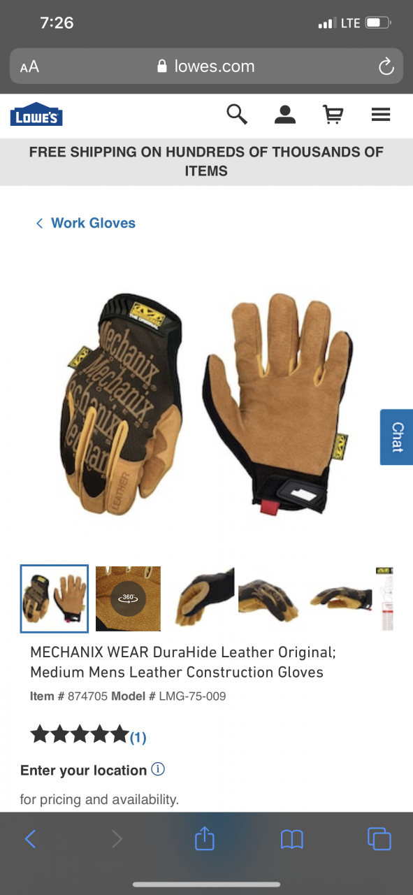

    Just clarify, I don’t wish to misleading. The glove setup I mentioned was more for working on the truck fixing stuff in the cold. So the fingers can move, still be flexible and be halfway warm.
    these in the picture are the ones I use year round except in the winter. Usually get about 2-3 months out then give or take. 0FCC4828-5E5A-4CEA-924E-6A20FA694F9E.png

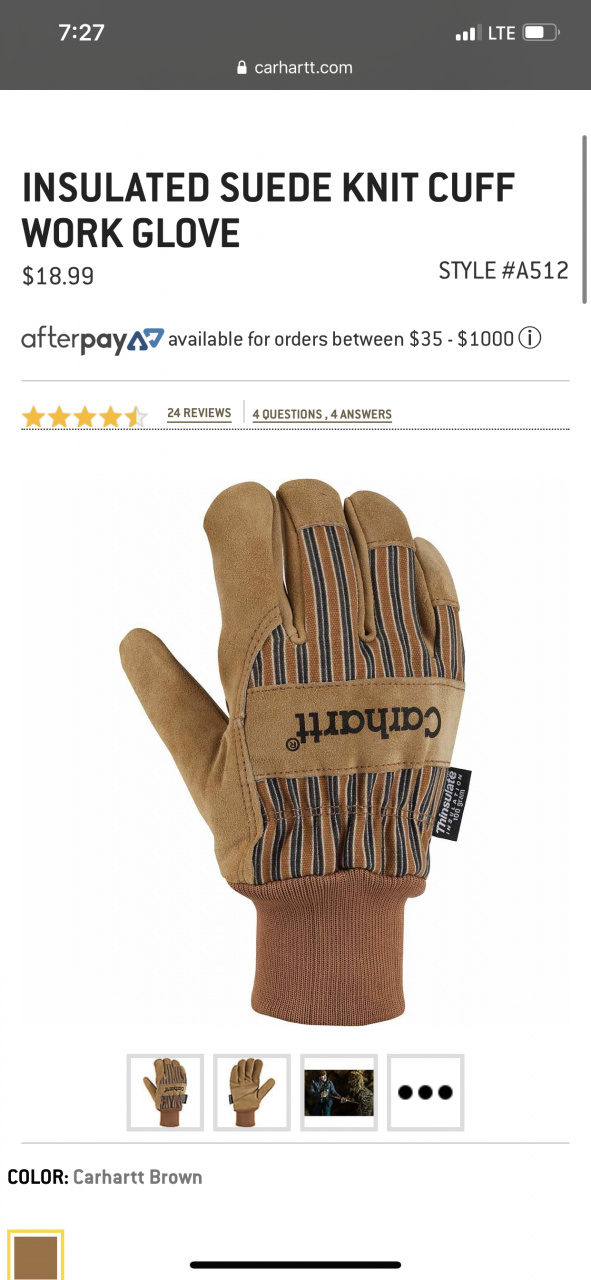

    These are the extra gloves I picked up for all purpose this winter. Fueling and flatbed etc. E546DBFD-FE5F-4DE0-BC53-8B1C3AE1EBFF.png

    The mechanix pair is very good for hot summer days at the auction house when you have to drive cars right away while they are baking in the hot summer sun.
    But not nearly as good in a proper winter cold as in below zero. Any time you can get gloves that are insulated you will be much better off. As well as protecting your health.
