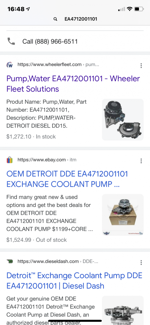

    72211CD8-F9B2-4C6F-B917-7E9C5B129848.png Says in stock but not sure. Don think the fixed coolant pump will work as the variable has a speed sensor. May be able to jump the pins and keep engine running with light of code. Believe they are same bolt pattern?.
