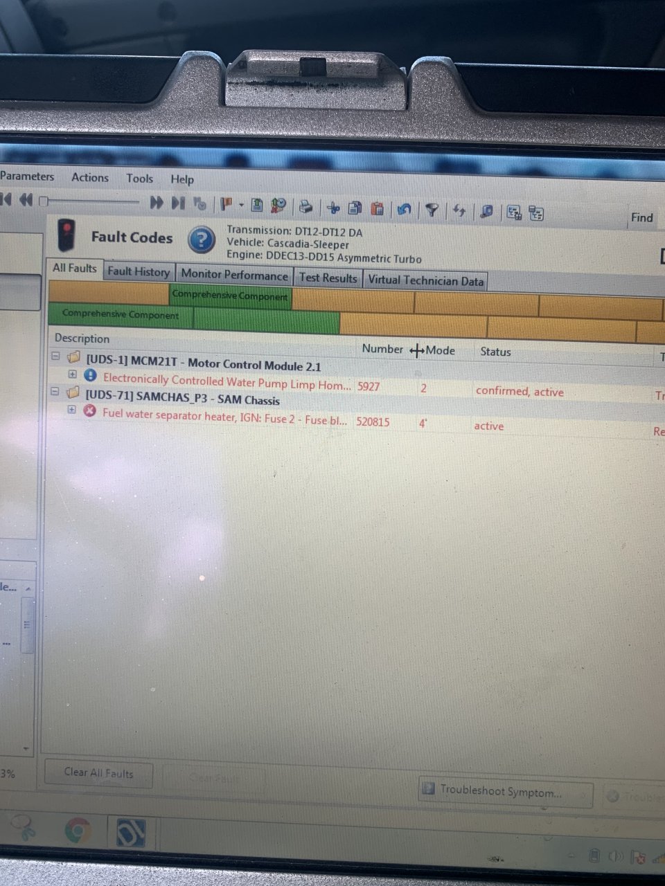

    Have a question. I had a mechanical water pump installed instead of the variable speed one since none available. Went in the system disabled the water pump speed control and i get this code yet

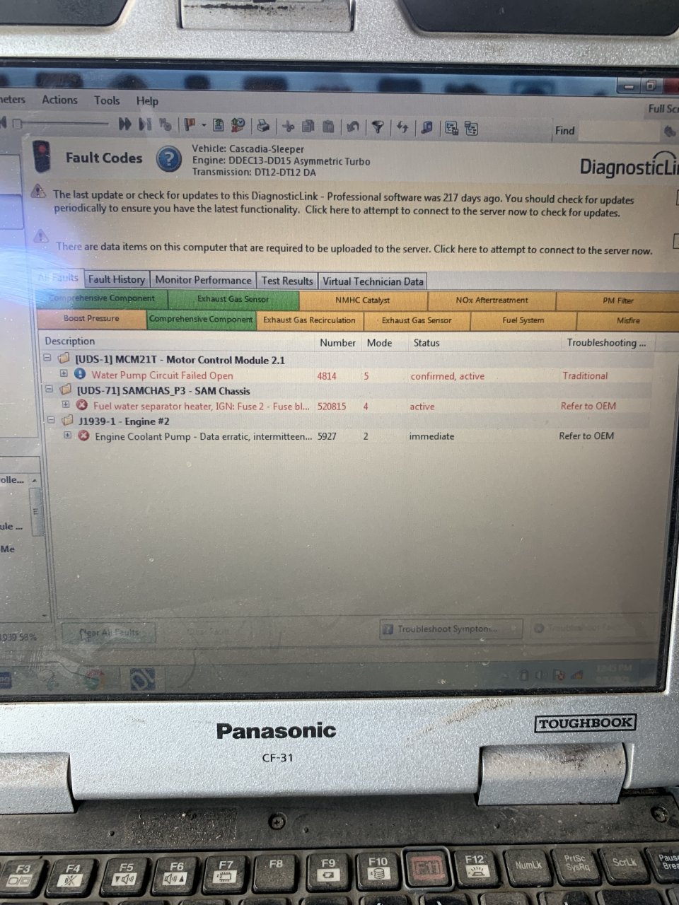

    I installed a mechanical water pump in place of the variable speed one that u cant get. Disabled the water pump speed sensor in the computer and it still gives me this code

    Anyone have any idea why this ain’t working when done the steps suggested on here? Trucks down driver sitting

    Sorry for the late response. Driving night sleeping when daylight. Not much time for fallowing the forums.R you positive the codes come up after changing the multiplexer?

    Yes and we had to take and hook up the sensor outta the old pump too otherwise we had more codes come up. Went through step by step disabled water pump speed.

    What year and make and model? Ghg14 or Ghg17? Interesting situation. I like to investigate Thanks. My programer guy want to know. We do not have that problem previously. The solution is there just need more info. Thanks.

    Ghg14
