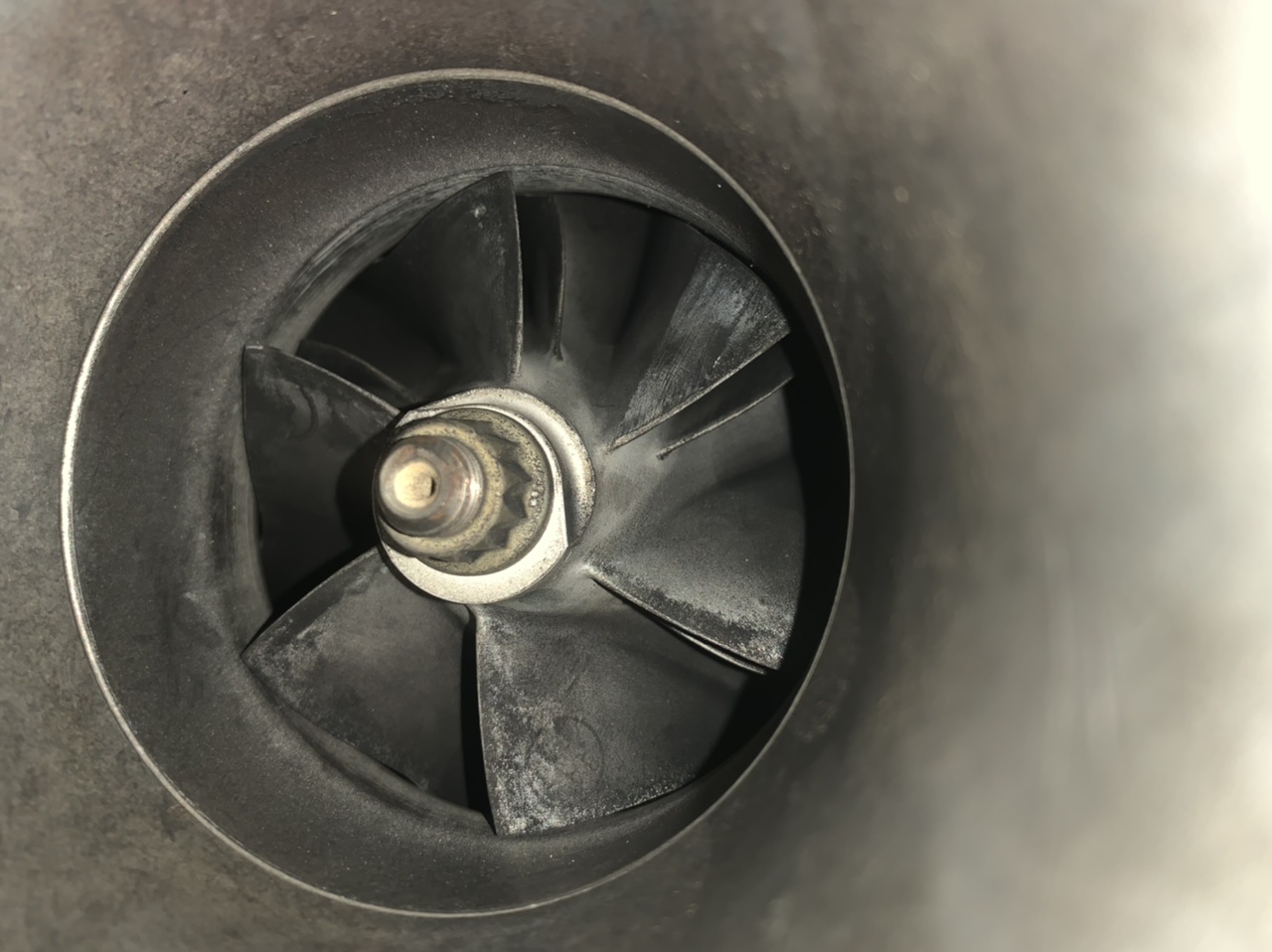

    Issue #2: I have some side to side play in the turbo shaft. It looks like the turbo has lightly scraped the side before. Could a bad turbo also be causing my smoke and blow by? Should I be ordering a new turbo ASAP? I don't want to break a blade off. If so, what Turbo would you recommend for replacement?

    11B727F1-1E30-4729-A6C8-1DCED05DAF35.jpeg Here’s a pic of the turbo inlet.

    Turbo's on its way out. Shouldn't be scraping the side like that

    Caterpillar reuse and salvage guidelines indicate any contact between turbine/compressor wheels and housing is grounds for replacement.

    Thank you!!! I figured that might have been the case on the turbo. I will start looking for a new turbo and work on getting my oil sample done.
