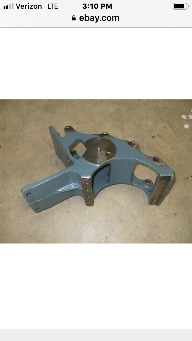

    I converted my 2000 Classic Detroit 12.7 A/C to a Sanden compressor. Now, I’m getting the proper bracket. Anyone with this set up? pad mount alternator, and pad mount Sanden a/c compressor? 8 rib serpentine belt with tensioner. I’ll need a shorter belt, than current modified bracket. Need a part # or length of belt in inches, or last 6 of vin # of a Truck with this set up. Thanks

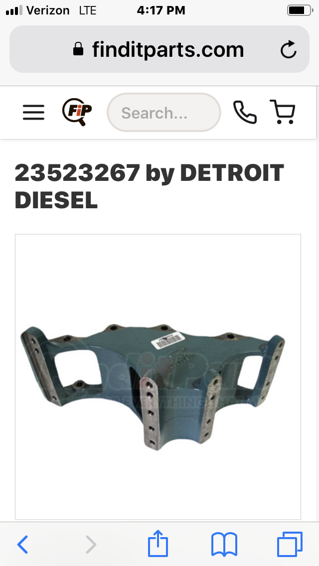

    337CF113-0423-4DB7-A9DE-021C993BD9B4.png A1DE4B0A-E427-4A20-A860-FAF4B712801B.png The new bracket is the #3267

    Have you had any problems with broken bolts on the bracket?

    I haven’t had any issues at all with broken bolts.
    Are you having this problem?
    A lot of times broken accessory drive bolts can be traced back to a bad engine vibration dampener.
