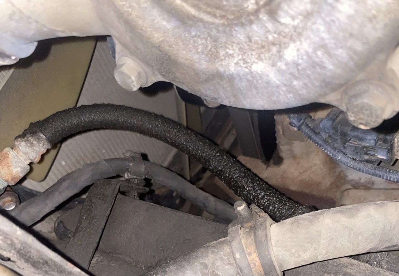

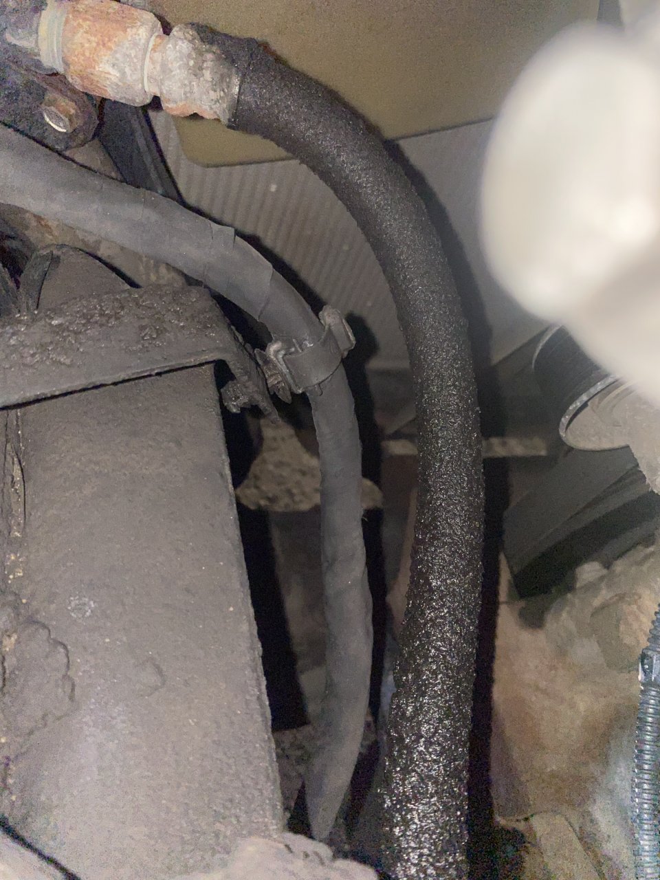

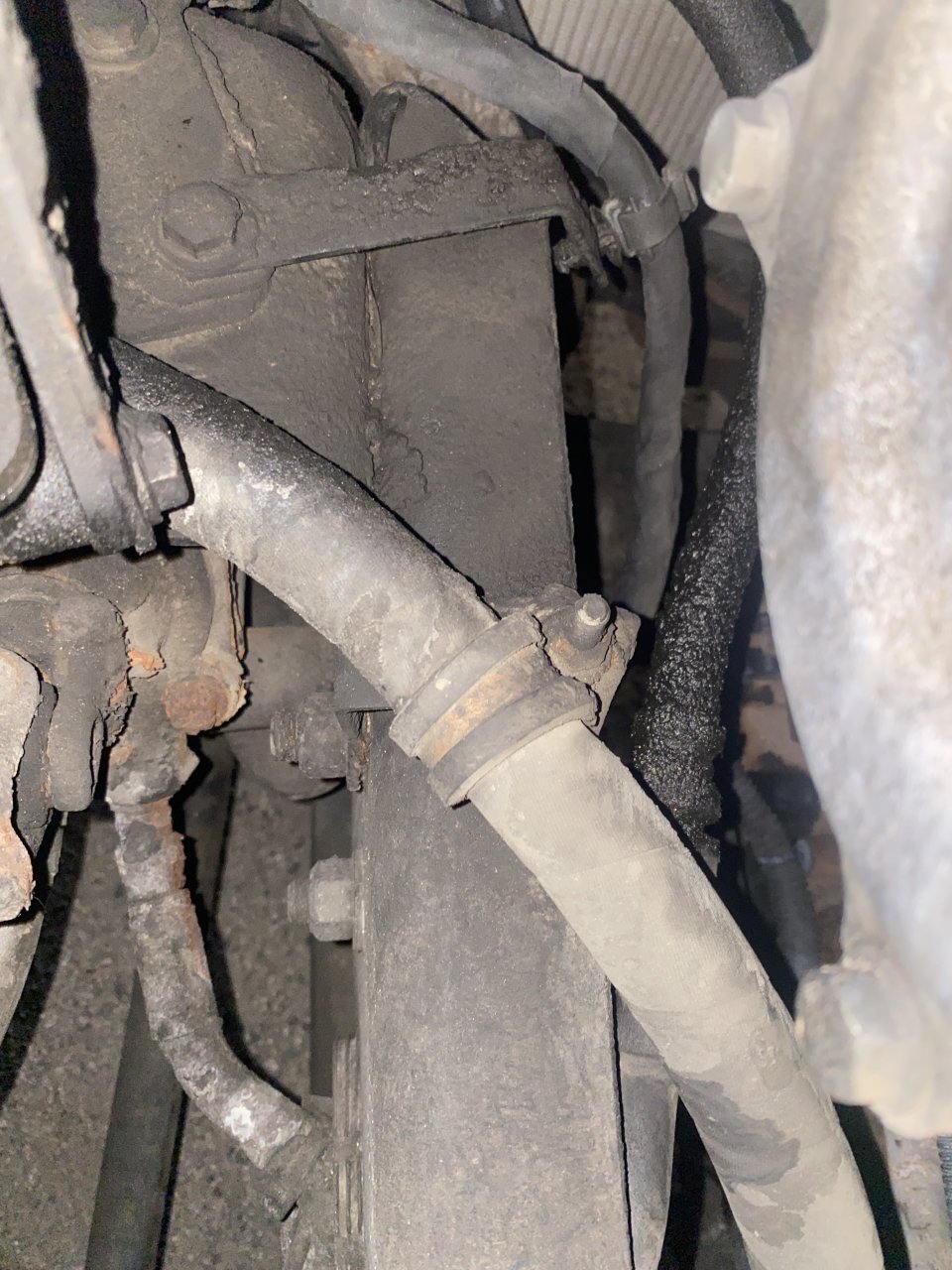

    IMG_8106.jpeg IMG_8101.jpeg IMG_8102.jpeg IMG_8107.jpeg Can anyone tell me what hose this is?
    2019 Freightliner Cascadia Evo DD15
    it’s a wire braided hose (12” possibly) that runs close to the driver side inner frame to the side of the power steering reservoir just behind the radiator. I don’t know if it’s a coolant heater hose, power steering hose, or potentially a compressor hose? I have reddish orange fluid (coolant or power steering) building up on the top of the wheel guard and that’s the only hose I see with any liquid or wetness.

    what fluid is in the Freightliner power steering sector - Search
    I don't know for sure. Reading the link above and the color you say the fluid is. I think the braided line is a power steering line. With the amount of fluid soaking thru the hose. Replace with same type. Make sure you bleed the lines after replacing.
    Freightliner should be able to tell you part#, good chance they have it in stock.
    Take the old hose off and have a new one made to fit. Parker Hose is a good place to have hoses custom and pre-sized hoses of all types.
    Good luck

    Where does the hose go into? If its p/s in a pinch you can replace with same size silicon or rubber hose and clamp. Looks more like a fuel line or oil line with that type of connector tho

    Does it go to a steel line that runs in front of the radiator?
    If so it’s the compressor discharge line.

    yes, I’ll have to double check but I’m 90% certain it does. Is this the line that the hot processed coolant from the compressor travels through?

    Most likely the compressor is passing a little oil.
    That’s not the source of the leak showing up on the splash guard.

    I’ll have to see if I can pin point the leak. The drag link has splash marks and the power steering reservoir is coated with dirt. I tried building pressure in the system to see if I can recreate a spray but I haven’t been able to recreate it. It looks like orange Dexcool, which I don’t use. I use Red 50/50. I’ll post a video of it later.

    No,nothing but air in that line.
    Coolant line for the compressor is above it and runs down the side of the block.
