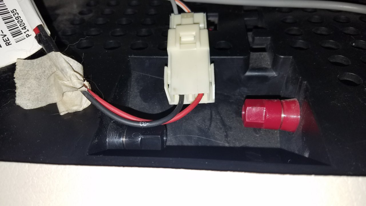

    Hello peoples. I was given a newer truck by my company. A 2015 Volvo 670. I have a general lee cb I took from my other truck but found I could not find the power cord to plug into the cb. There is the antenna cord and I will include a picture of the other wires as well as the red and blue input looking thingys. Any help I would find pleasing.

    Are you trolling?
    Do you really not see the positive and negative 12V connections in the picture?

    May have never used binding posts.
    Twist the red & black cylinders.
    A power cord with soldered tips is best.
    Insert into hole cut thru, and tighten.

    Buy a cheap DC volt ohm meter. Then you will know what's positive and what is ground. If that's the problem your having.
