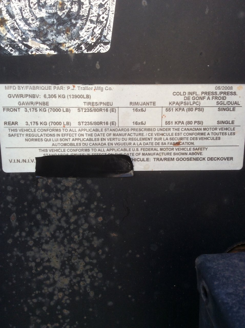

    You need to understand that your truck and trailer were manufactured with data plates/stickers, that tell you what the weight capacity is. But look at it this way, you state that trailer has 2 12,000lbs axles. That’s 24,000lbs . If trailer weighs 9500 pounds, the freight can weigh 14,500
    As to what you can legally haul depends on other factors. If you don’t have a cdl, you cannot weigh more than 26,000 lbs. if you have cheap tires, that have a weight limit of 1200 lbs, you could not put but 100 lbs in freight on trailer. Cause 1200 lbs X. 8 tires equals 9600 lbs.
    If you are registered for 26,000 lbs and we already know your rig weighs 20,400, you can legally haul 5600 lbs
    You must also understand, that a Dot officer may use axle capacity, and wheel/tire capacity to determine allowable weight. IN THE ABSENCE of manufacturers data plate.
    In all my years, if you have the proper cdl, for it. The weight is under what you have it registered for, and the tires have the capacity for it, you’ll be just fine.

    When I had my crappy 2001 Ford F350 with a 53' wedge trailer, I too was confused on what my legal weight limit because the sticker on the door says i can tow maximum of less than 10k lbs. My trailer with 3 cars will be way more than 10k lbs.
    I called around 2016 to a North Carolina scale house and spoke to a Sergeant in Commercial Vehicle enforcement and here are the facts in NC.
    - Weight Sticker on 1 ton pickup is ignored for weight limit.
    - Dually axle on pickup can have 20k lbs because it have 4 tires.
    - On Trailer, weight will be based on axle rating.
    - Gross rating must not exceed your Weighted License Plate (NC have fees on base plates based on weight above 6k lbs) or declared Weight on License Plate with IRP.
    - In NC, if your gross weight is over 26k, You better have an IRP plate with Declared weight to support it or fines will be issues.
    Troopers use this as a general guide line but if they choose, they may use the rate ratings on tires. In this case, the 4 tires on the dually will not support 20k lbs because my tires were around 3500lbs each.
    **** Very important in NC. If trailer have gross rating above 10k lbs even if empty and under 26k lbs, you need CLASS A License or big fine.
    With my 2001 F350 (no bed) and 53' Kaufman wedge trailer, my empty weight was around 15K lbs. I bought and tag it for 40k lbs gross declare weight with an IRP.
