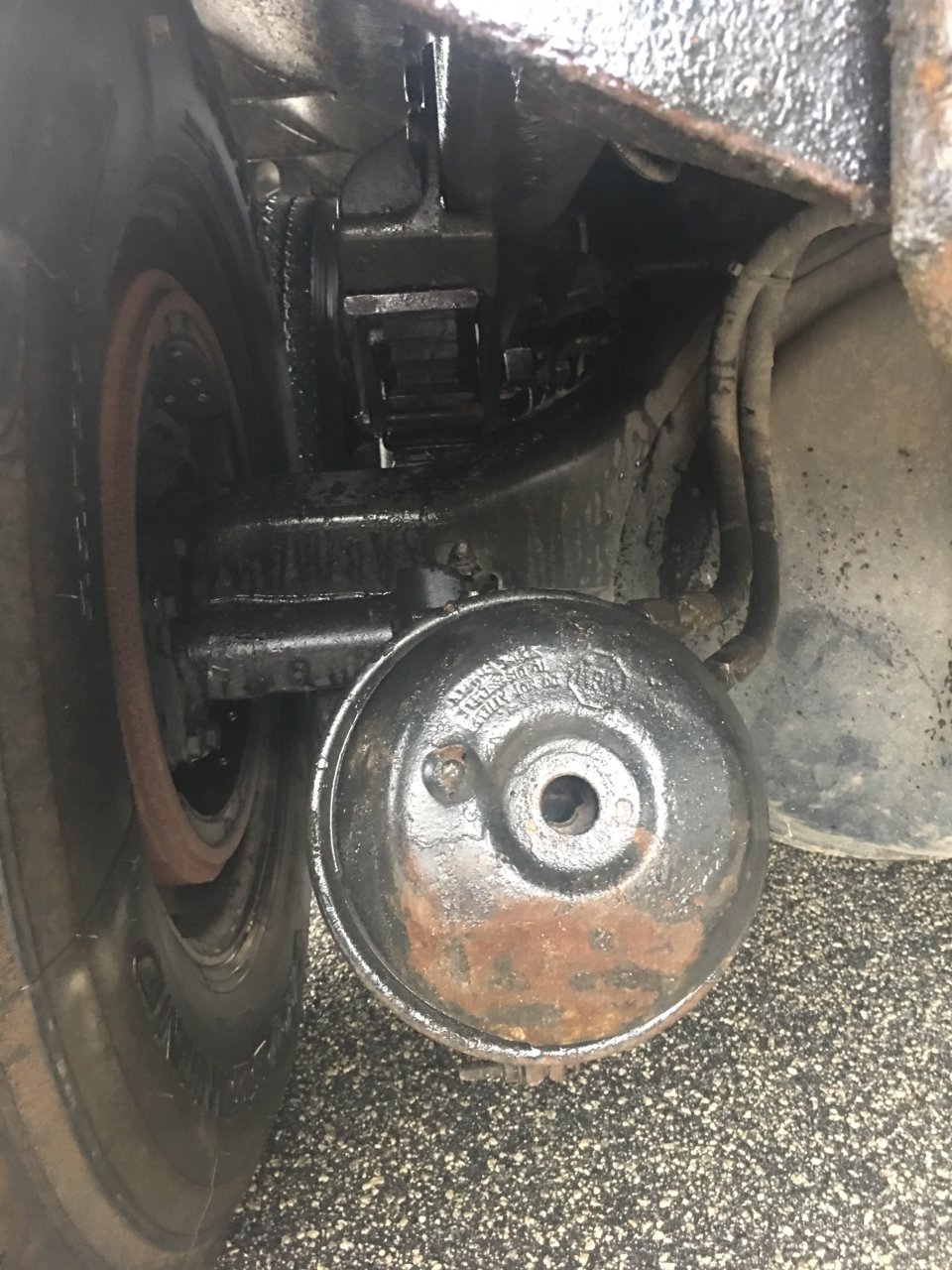

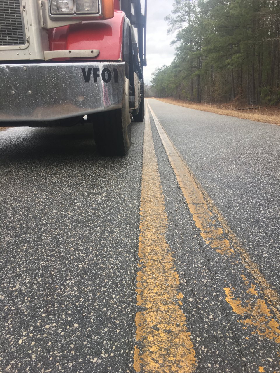

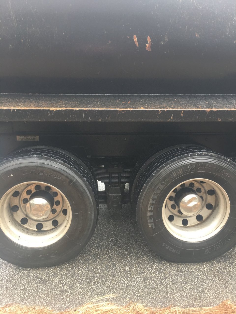

    I replaced both spring packs this past weeknd on my 96 357 peterbilt dump truck. The truck has rte 460 suspension which is 46000 rears and mine has the little tail off the end of the leaf spring. far as the walking beams goes it can not be shimmed with the two bolts per end mine. just has one bolt per end that holds beam to axle so no adjustment there. this truck has play in the steering wheel this truck always has driven straight as an arrow, but now this truck feels like it's crab walking down the road. Front is pulling to passenger side rear is pulling to driver side. Rear axle looks to be In further than front drive axle and vice versa on passenger side looking at the tires in the mirror. My question is did I miss something when I put it back together? does the set screws at the top of the leaf spring cap align the springs which align the parts the walking beams are held to or what? The tires used to be perfectly straight with the bed when looking in mirror now they are out of wack. Do walking beams have alignment adjustments or what?

    I will have to check into that. this truck drove straight as an arrow before, now it feels like its dog walking. front drive goes towards driver side not much but rear drive goes towards passenger side they seem to be about 1/2" out. where as they used to track perfectly straight. both rear axles in mirror used to make first set of lugs on the tires dead even with dump body.

    The leafs used to ride dead even in the saddles on the truck now the both ride to the outside of the saddles the truck has about an 1.5" of play when turning with a load other than turning they used to stay straight in line.

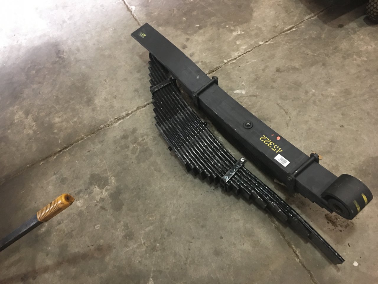

    This is the spring set up I have on my truck the saddle which is the piece that the walking beams actually hook to have maybe and 1/8" of play to them if you push with a prybar

    The truck is dog walking that bad
