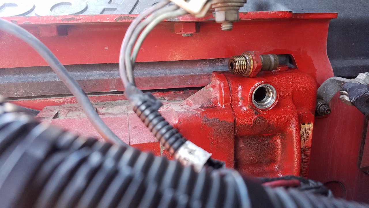

    20161009_121014.jpg 20161009_120949.jpg My ISX gets airbound on every single fule filter change. Every single time for the past 4 years I bought this truck. I have noticed that when I am at a Peterbilt or a TA/Petro, the techs will hook up one of those hand pump cans of fuel and hook it up to the compucheck fitting over the fuel filters. They would pump several times and would try cranking for a few seconds. It would take them about 4 or 5 times of pumping while I tried cranking. It would then start.
    Disclaimer: Im not a mechanic just an owner of my own equipment.
    The pics below show you the compucheck fitting. I don't own one of those hand pumps so I just took off the fitting and using a dry sports bottle filled with fuel and squeezed fuel into this hole. Closed it, tried cranking, repeated 4 times and it started. Oh the compucheck fitting may have a red rubber cap on it, so you may not be able to find it right away. 20161009_120956.jpg
