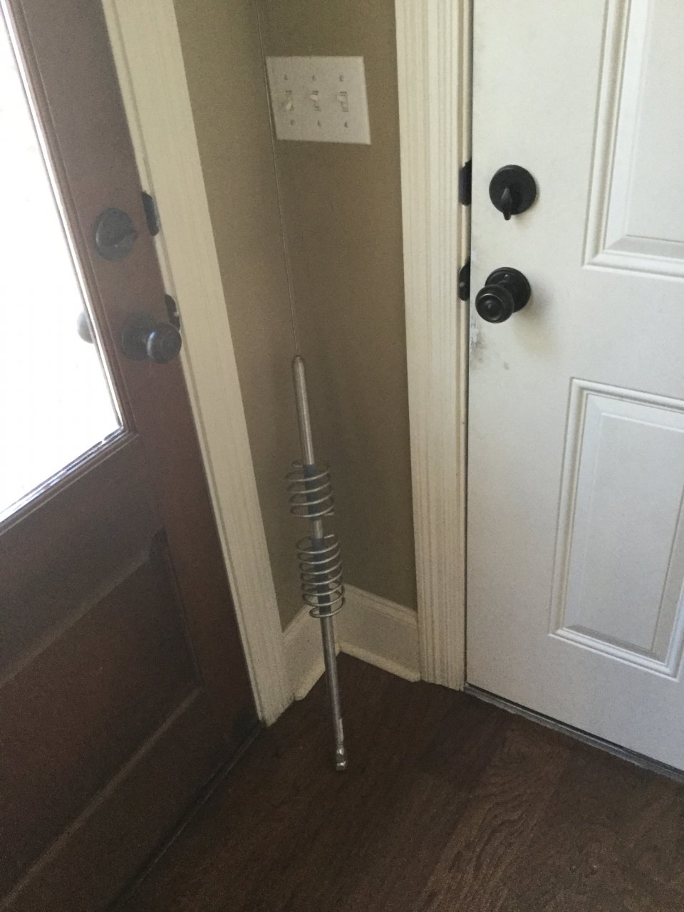

    Alright, in a nut shell I’ve been in the hobby for awhile and upgrading. Recently upgraded from a Ranger RCI69VHP with a 4 pill to a Ranger RCI69FFB4 to get rid of space the box takes. Removed the RG8X 98% shielded and installed LMR400 coax, SWR current at 1.1:1 on Predator 10k antenna... now... due to being in a Volvo (laugh now, make your smart ### comments and move on) I’ve had to mount the perch to the screw at top of the mirror mount and the Predator with 6” shaft is too long, antenna stands almost straight up at 80 mph, otherwise leans forward a good bit. So... my question to everyone, recommendation on high performance antenna, shorter the better... magnet mounts aren’t an option, and if your going to say Wilson, Francis or Firestik, please don’t even respond. I know there are a few high end ones out there, some in excess of $500... just can’t recall names to search for them. Using VHF majority and some UHF, not using SSB much. Thanks in advance!

    Don't know which Predator 10K you have, but if it's just too tall for you, you can always add a second smaller coil to the antenna to get it to tune shorter...All you would need to do is buy one of the small coils, and the spacer that would go between the old coil and the new smaller one...Unscrew the top section of your 10K from the top of the coil, then add the spacer and new smaller coil, then screw the top section back on, and your good to go!
    Adding the small coil should shorten the antenna by at least a foot...(more or less)
    You can either call the number on the shaft of your 10K and talk to Kale and have him send you the parts, or check with Clay's Radio Shop, they carry parts for the Predators. Clays Radio Shop Home Page

    Like Jessie said, run a dual coil short whip 10k and get the Volvo specific mirror mount. I ground off the texture, put that hoop style mount on that clamps to the big top mirror arm and ran a ground wire from the mount to the mirror bolt. Run your radio power and ground to the battery and use the battery frame ground.
    I did this in a 2013 Volvo running a 1x4 and never had a single issue. Zero reflect, no ecm interference and excellent results TX/Rx especially talking skip. Total height is 58 inches with 12 inch shaft and heavy duty mount. Slight forward tilt.
