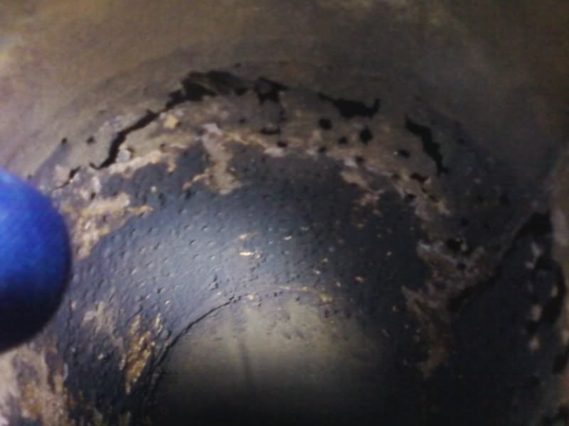

    Here's the new muffs, (Donaldson M100463) very little restriction.................you can look straight thru them
    Here's the old muffs, rusting apart, There's a baffle in the middle of it and all those little holes are plugging up
    Like others have said, this is probably the best bang for your buck when it comes to freeing up horsepower and better MPG.
