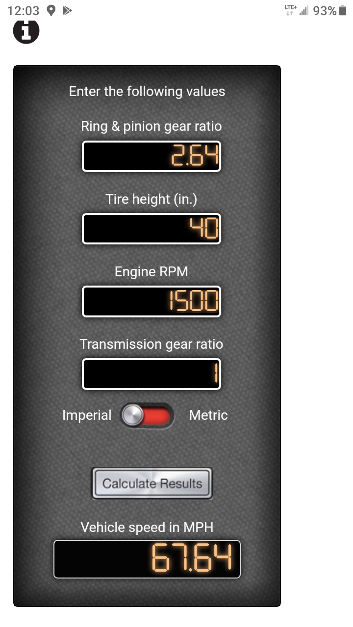

    That sounds pretty close to where it's supposed to be for low pro 22.5 tires..

    Ok you've started another thread like this in the past 4 or 5 months. Is it the same issue or is this something new? I know you've deleted the truck and the transmission was swapped out to a different model. Did you ever get the parameters in the ECM verified to see they were set up correctly? Did you ever bother to look up the transmission ratios for each gear and plug them into a calculator like @singlescrewshaker posted? That'd tell you right away if this issue is related to the wrong transmission being installed or if its an issue with the ECM program from the delete. Hell if the transmission was changed there could be the wrong tone ring on the output shaft and its giving the wrong signal to the speedometer.
