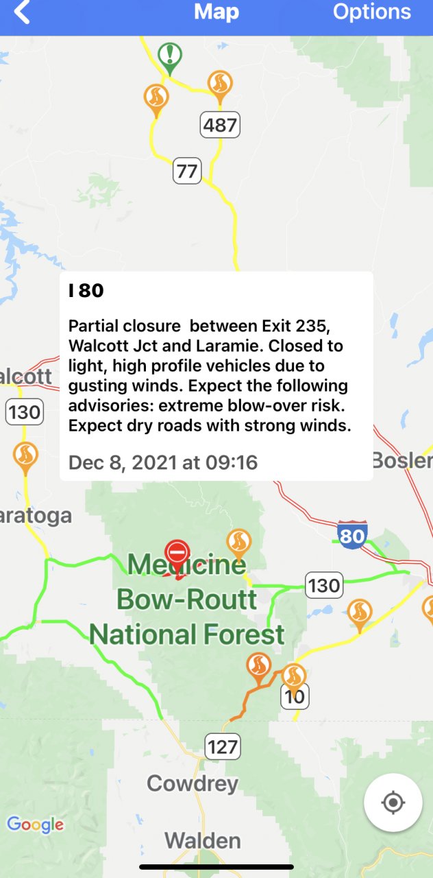

    Same here! As a suggestion Wyoming has a good DOT site for road conditions. I got stuck last winter just East of Elk Mountain with a light load. Wyoming DOT had road closed for light, high profile vehicles. I'd check their web site to find out. Besides safety, if Wyoming DOT does have the road restricted for light, high profile vehicles, you're setting yourself up for trouble with the po po if you get on the road.

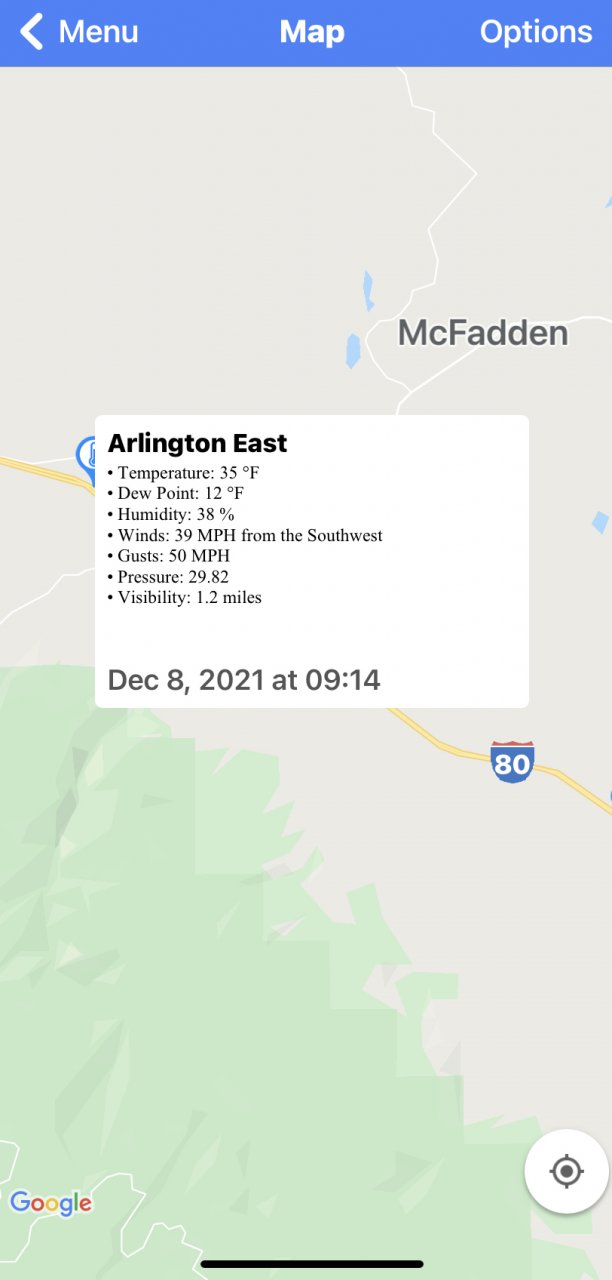

    182B9B6A-0CA6-4AD2-AE3B-6375530E0D57.jpeg D60262E7-420C-49E3-A456-4FF2629C8292.jpeg
    Current info from wyoming dot..
