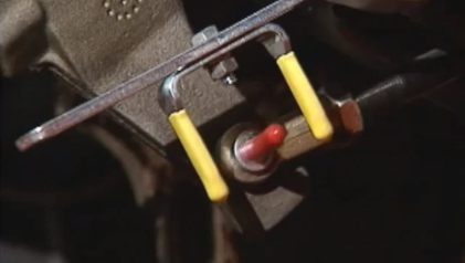

    I was thinking about this thread just looking around for new trucks, (but i gave up, too expensive with this exchange rate, i'll keep fixing my older truck ). I noticed brand new trucks still at the dealer here in Ontario, don't have any kind of indicator,(sorry not very good photo.)
    Should the buyer install push rod indicators before hits the road or is dealer responsibility to sell trucks in compliance with provincial laws? Not many drivers are aware that can be fined 500$ and bunch of points on CVOR, driving a new truck out of dealer gate.
