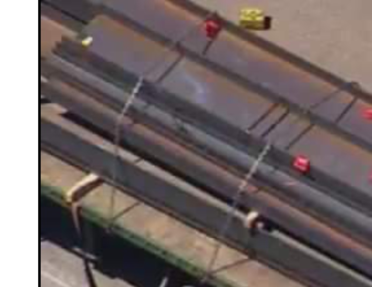

    That just doesn't look right.

    Ok, so 2, maybe more. Just think that a seasoned driver would have done better. But I could be completely wrong.

  4. JoeyJunk
    JoeyJunk Road Train Member
    8,762
    68,032
    Dec 31, 2010
    Washington, PA
    I agree 100%. Was just stating there were some chains. I guess I have no basis to talk about chains as these are the only chains I have experience with. :biggrin_2559:

  5. D.Tibbitt
    22,735
    157,141
    Why not throw some cross chains on the front takes 15 minutes.. I always cross chain beams like that, i never see any other flatbedders do it though. I dont think i could feel safe running beams without em....i never been a fan of straps on steel but its not illegal... Needless to say he is very luck his head is not hanging from the front of the load

  7. BCV
    BCV Light Load Member
    233
    436
    May 26, 2018
    I was parked next to a ol timer yesterday who had his beams set up w cross chains on the front like that... Caught my attention and made complete sense.

  8. drvrtech77
    drvrtech77 Road Train Member
    15,518
    151,857
    Mar 20, 2010
    Straps are ok as long as edge protectors are used...also 4" straps have as 5400lb wll...and you also need 2 straps within the first 10 ft of load....chains are usually preferred on that type of load...

  10. Expeditor
    Expeditor Medium Load Member
    451
    530
    Mar 5, 2018
    You are right, if you look at the 10 minute mark there are no chains. Now fast forward to 25 and you see the firemen placing chains to hold the load from tipping forward towards the front of the truck.

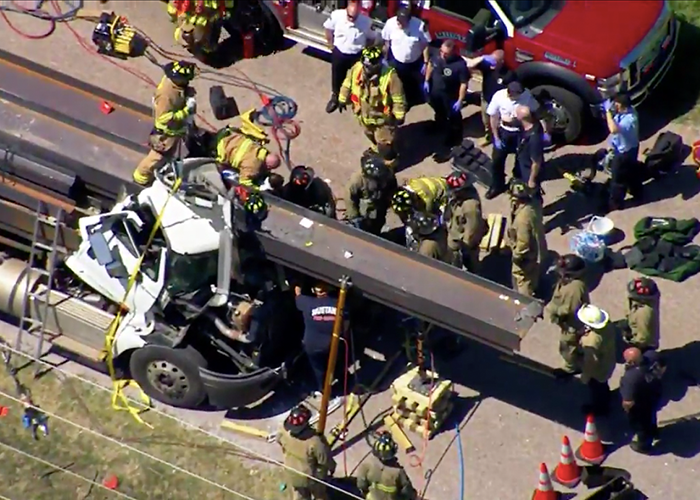

  11. lovesthedrive
    lovesthedrive R.I.P.
    15,953
    54,484
    Nov 11, 2008
    Sorrento Maine
    Talkk about luck. Wondering if he got scalped. Looks some what like hair on the end of the beam
