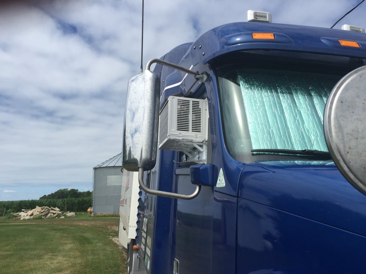

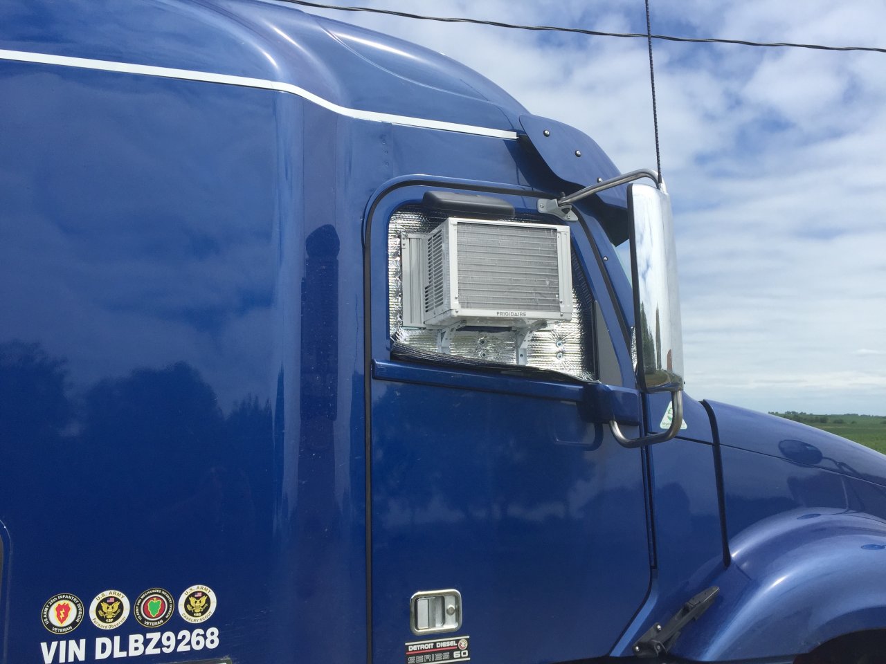

    Just did my holiday project and got setup for window A/C. Already had a Yamaha EF2000 generator in its own frame rail box for some time. The Columbia I have has one of those one piece window designs that made it necessary to take sheet of 1/2" plywood and cut out a section to mount A/C unit. Nice thing is, there is a little over 1/2" wide channel all the way around the window area, and once I cut the Plywood to match, I fit it in, close the door, and I have a nice sealed setup. I put reflective insulation material on the outside of the plywood to radiate heat away. Setup works like a champ! Easy to install and remove A/C unit and the plywood frame. The A/C is not permanently mounted on the plywood frame. I extended the reflective insulation so that it covers over the lowered window and door sill to protect it. Total cost... about $160. The bracket supports for the A/C are spring loaded and fold down. Makes it nice to store everything away in the truck.
    mhyn, Terry270, Hurst and 1 other person Thank this.

    I liked it. Also I liked the stickers you have above VIN ! Respect !
