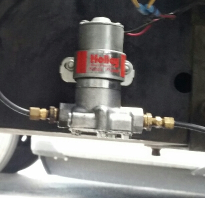

    I use a Holley Red pump to feed my TK APU. It's made for carbureted applications so it's regulated to 7 psi max. It should work for a generator.
    As an aside, if any of you are tired of paying for a new fuel pump on your APU every 6 months to a year, get a Holley Red pump. They last a lot longer and your APU will start instantly with no bogging down like the factory pump. I'd recommend mounting it outside the APU enclosure. Mine is mounted to the side of my toolbox that is directly in front of the APU.

    I was using those inline Mr. Gasket pumps. The first time it would run low on fuel and suck air, the pump was toast. Same with the OEM TK pumps.
    The Holley pumps seem to be much more forgiving in that area.
