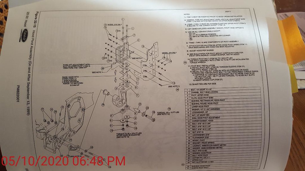

    So your hood swings to the right as you opening it? Am I understanding that correctly?
    While you are in there replacing bushings and stuff I want to point out that the assembly in the photo you posted has 2 adjustment points. 1 will slide the hood forward or backward when those 2 bushing bolts are loose. If they are not even side to side the hood could swing like you describe.The 2nd adjustment is up and down by way of shims.
    Rideandrepair and spindrift Thank this.

    The hood wants to move to the right when I'm closing it.
    When I installed those new rubber spacers that are shown in the first pic, I just cranked down on the nuts. I did notice that the nuts were further out on one side. I thought the bolt lengths were different but I'll check again.

    Those nuts are 55 ft lb.
    I am trying to upload a photo I took of the hood pivot assembly for 1999 and on 379 page in my Peterbilt book. It has some torque specs and parts layout that might help but, it's fighting me. I'll keep poking away at it.
    Rideandrepair Thanks this.
