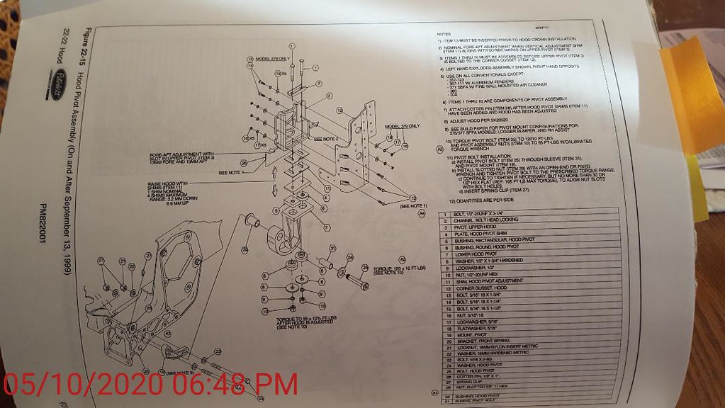

    Hey Luwi...Can you tell me what the torque setting is for the nuts in my first pic?

    The book says 55 ft lb.

    Just got the bolt kit from Rush. Going to give it a shot next week.

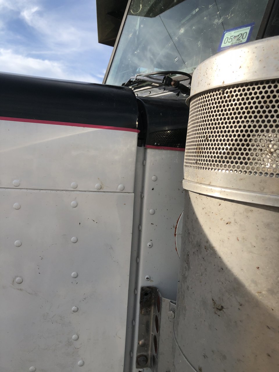

    Has new bushings and for some reason the right side sits prefect but the left stays like this. Any idea ?
  8. TexasBoy21
    TexasBoy21 Bobtail Member
    16
    2
    Jun 22, 2017
    Any help will be appreciated

    How about it @spindrift. Ever get your hood figured out?

    Nope...bought the front hinge hardware but other issues have kept me from doing the work.
    If OPs front, rubber bushings are shot, I'd start there. Mine had pretty much disintegrated. Whatever they were supposed to do wasn't gettin' done.

    @wore out may have some ideas. I would look at the hood roller on that side and make sure it’s not binding up. @pushbroom saw a Peterbilt one time... I think ;)
