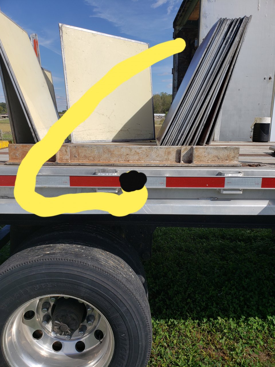

  6. jamespmack
    I dont like it, but have had to do it. It all depends if trailer was made for it.
    I go down round spool and over the the far side of a stake pocket back to rail. I only do it were I welded splash guards on.
    Dont be to critical of my drawing.
    Never cut one, but some may wanna put felt or rubber under pocket.
    Simple hook straight to the rail dont cut it.

    Don’t worry if I drew that with my finger you wouldn’t know what the heck you’re looking at
