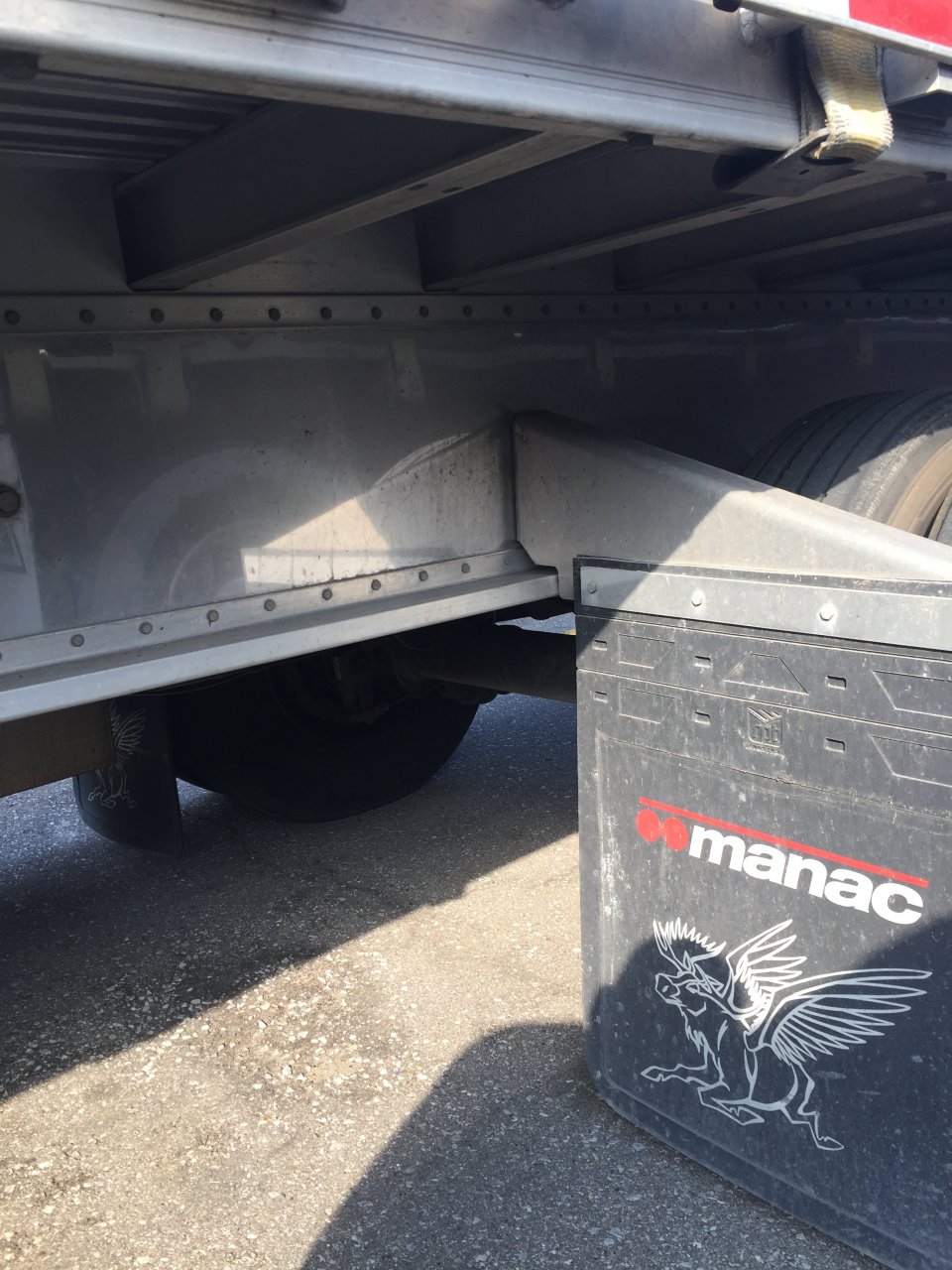

    There's an aluminum Manac parked next to me so I had to check it out. The trailer beam is riveted to its flanges so I can see why you wouldn't want a lot of side pull. IMG_1237.JPG

    The few Manac's I've pulled have all been garbage trailers. They just seem like a step down in terms of quality from MAC, East or Wilson.
