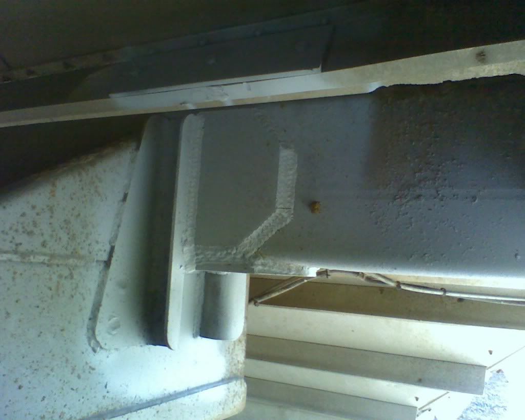

Hwypilot I for 1 would be interested in pics of them trailer welds if you can put them on here.

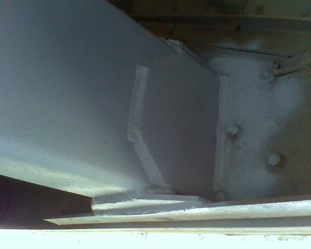

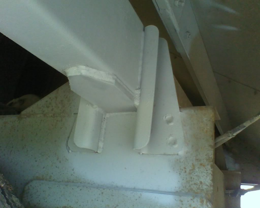

The front beam directly behind the rear hopper (shown) was the location of the issues on the older trailers, according to the Wilson dealer I was talking to. They'd replaced the beams completely in the past, costing between $2k-3k depending on the extent of the damage from flexing. They usually crack and/or break out on the back side of the frame rail of the trailer, then the flexing causes damage to the inward bracing.
The fix was to brace up the areas with gussets of 1/4" steel plate, and seam weld the contact and stress points on the subframe unit. I'd have all of them done if it were mine (and I could afford it), but this repair work fixes the main problem area and made the trailer roadworthy again.
