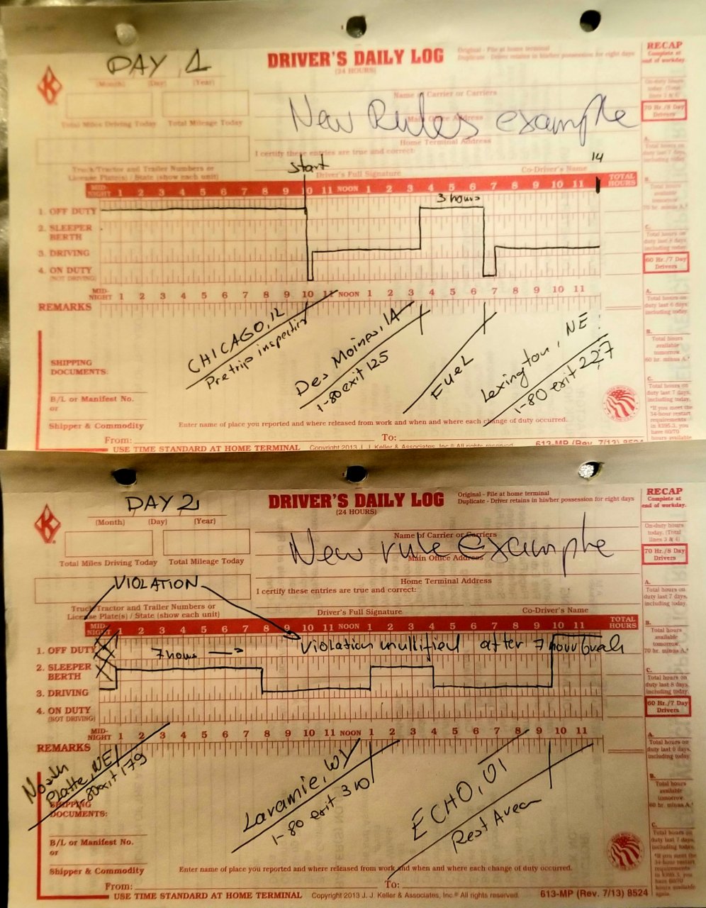

    OK TallJoe, without having read any of the replies it may have generated, here's what I can tell you about your logging example. Your 14-hour violation from midnight to 00:45 is still a violation under the new rule. Here's why: the 14-hour clock that neither the 3+ break nor the 7+ break counts against under the new rule, begins when you ended the 3+ break, NOT when you first began driving earlier in the day. That's just how split logging works---always did, still does.
    As far as I can tell, there are no new scenarios in which the legality of driving ever depends on some future break you may or may not take. As was the case before, and continues to be, you're either currently legal to drive or not, period, at any given minute during the day.
    Trucker61016 Thanks this.

    "Sleeper Berth Provision
    Modifies the sleeper berth exception to allow a driver to meet the 10-hour minimum off-duty requirement by spending at least 7 hours of that period in the berth combined with a minimum off-duty period of at least 2 hours spent inside or outside the berth, provided the two periods total at least 10 hours. When used together as specified, neither qualify period counts against the 14-hour driving window."
    I am not sure if I am able to follow your logic. It sounds like you are overcomplicating it...perhaps you got entangled by FMCSA wordage from some other clause than the one I just cited.
    Where is the clause which makes you say that my example is not HOS compliant?
    If you're referring to my example on paper then it is obvious to me that my 14 hour shift started exactly at 10 am and then after taking 3 hour off duty break from 3:30 pm to 6:30 pm was consequently extended by 3 hours until 1:00 am the next day.
    My second example (post# 77) is a real life case which I did and while there was a violation shown on ELD, the violation had a status of "alleged" and it was nullified after the second qualifying break was completed: post# 78.
    Below, you will find a tool presented on the FMCSA site with already prewritten examples showing sleeper berth provision violations and no violations, also you can enter your own hypothetical examples and see how the provision works. My examples are passing the test.
